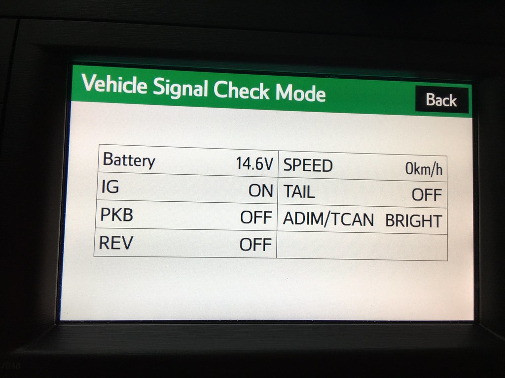

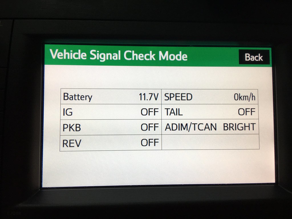

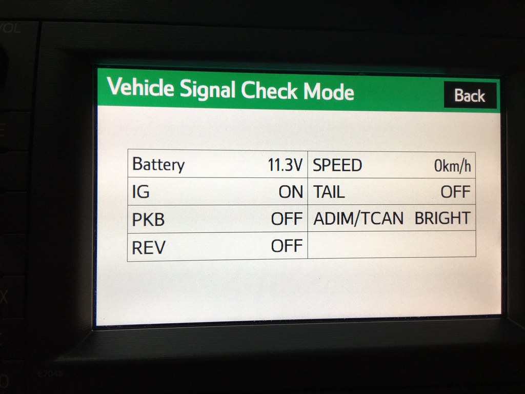

    Do I need a new 12v battery?
    On (1 push of the power button)
    Accessory mode (2 push of the power button)
    Ready

    Is the dome light "DIM", does the SKS system seem to work OK, have you had someone do a "Load Test" on the 12V battery? I only see broken icons to your image links! :confused:

    I fixed the pictures.

    from the pics, you need to try charging your battery. if it holds, great. if not, replace it. have you ever drained it?

    Push on button once, let navigation boot up, press and hold info and turn lights on and off three times then let go of the info button.

    You are missing the load test step. That is the step that determines if you need to replace the battery or not.
    1 push: 12.5v
    2 push: 12.2v
    Load test: 11.1v (turn on headlights, full blast heater, rear defrost)
    Ready test: 14.7v
    Those are my results for a 2012 plug in w/ 37.5k miles.

    Thanks. My 1 and 2 push is under 12v. Need new battery?
  14. bisco
    115,508
    52,891
    no way of knowing until you try charging it. but if you'd rather just drop a few hundred bucks, go for it.

    If that 11.7 is similar to what you'd get, measuring with a multimeter with the car shut down, that's not very good. Especially so if, as you said, you haven't accidentally drained it.
    I'd consider anything under 12.0 near dead. Try a smart charger, and then try testing with a tester that can test CCA. Thr dealership should have the latter.

    Yeah, the nav system is not an accurate measurement tool. Although mine is a previous generation, when it read 11.5V in Accessory mode, the actual battery voltage at the terminals was 12.17V. When the car was off, it was 12.5V, which is what it has been since basically the day I got it.
    My personal feeling is "if it ain't broke, don't fix it." So wait until your car doesn't start (or starts doing weird things), and then maybe you need a new battery. I'm still on my original battery, 6 years in. On the other hand, if you can't afford to have your car not start when the battery dies (maybe because your boss will fire you for being late, or if you live in a war zone and need to be able to make a quick getaway on short notice), maybe it's worth it to you to replace it early.

    Yea, decided to just leave it alone lol. Just saw a few post about it and thought I'd check mine.
