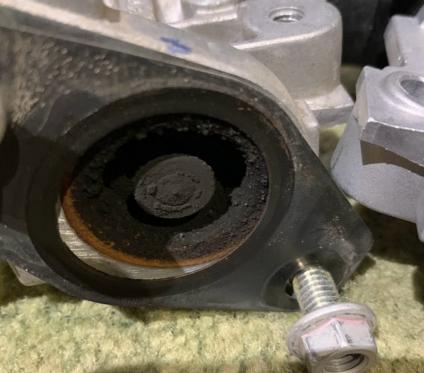

    At 170k miles, I am going to do some maintenance on the EGR system again. When I took the EGR out initially, I used a ton of brake cleaner on the cooler. Still saw a ton of carbon in there. I replaced the EGR valve with a new one, so no cleaning was needed there. But I took the old EGR valve and soaked her overnight in Purple Power and that stuff cleaned off all the carbon (I'll post pics tomorrow). No pressure spraying needed. I'll just get a rubber stopper to plug one end of the EGR cooler and then fill up the cooler with Purple Power and let her soak overnight. Even with 4 cans of brake cleaner (@$4/can), wasn't enough to do a good job cleaning the EGR cooler. Purple Power is less than $5/gallon at Walmart and does a better job. The trade off is that she'll be out of commission for 1 day as Purple Power does its thing overnight.

    I had similar experience, albeit with Oxi-Clean solution sub'd for Purple Power; I think they're in the same neighborhood chemically. And yeah: brake cleaner was not that effective, and not good for the environment.

    After you use the purple stuff or oxi, what do you do with the waste?????
    Oven cleaner, pressure washer, 45 minutes maybe....
    And it helps to have a spare cooler. (y)
    QuarterMileAAT likes this.

    Poured it in a spray bottle with plans to use it to clean the wheels on my truck later. I used 2 SOLO cups for the overnight soak.
    Keeping my eye out on one. If it can be had for cheap, I'll grab it. But all the used ones I see are going for a pretty hefty price (relatively speaking).
    Here is what the EGR valve looked like before (from an earlier post). No scrubbing or agitation of any sort. Just a soak and a rinse to wash away residual Purple Power:
    And after the overnight soak in Purple Power (no I didn't soak the solenoid):

    With anything but the (stainless steel) cooler I’d be inclined to avoid purple power: suspect it’s caustic, might react with aluminum, or reg steel. It’s only the cooler that really needs it. Brake cleaner with elbow grease is quite effective with the rest.
