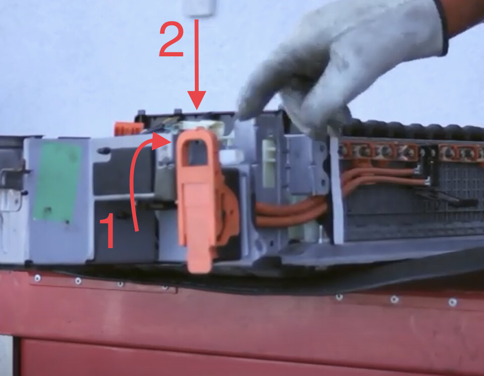

    Are you sure the orange service disconnect on the hybrid battery is folded shut and the clicked in?

    Yes. That bit me once before.

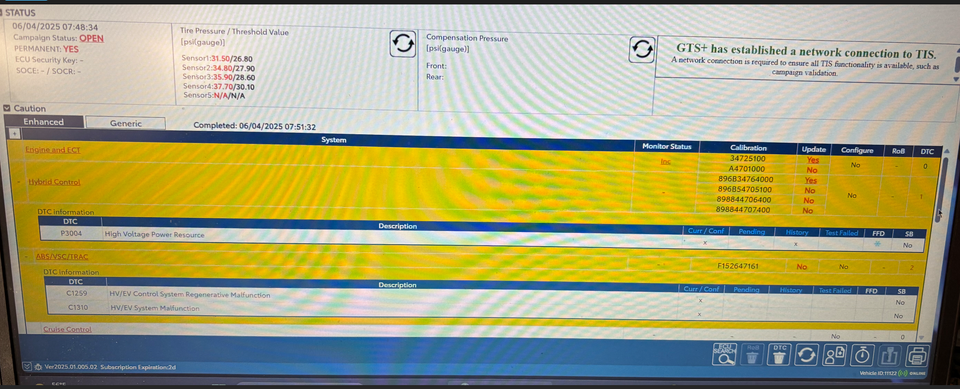

    Did you run a full Health Check using Techstream?
    The two codes you reported usually mean that there is at least one code reported by the hybrid control system. You have not included that code in your post.

    Yes. Did full health check. I will look again.

    After doing another Health Check, the Hybrid Control has code P3004. Any solutions?
  8. Brian1954
    Brian1954 Senior Member
    Jan 31, 2021
    2,611
    1,035
    South Central PA, USA
    To narrow down the problem for the P3004 code, you need the three digit INF code. You do that by double clicking on the snowflake to look at the freeze frame data (FFD). In the freeze frame data, there should be four rows labeled Detail Code 1, Detail Code 2, etc. The INF code will be shown in one of those rows.
  9. ChapmanF
    28,555
    18,897
    ^^ I was just signing in to say that. There seem to be about six different INF codes that can go with P3004.
    Regrettably, that's as much as I can tell you from the PDF copy of the gen 3 repair manual that floats around, because it hasn't got the actual troubleshooting section for P3004. Whoever made that PDF missed some sections.
    If it were my car, I would go sign in for the full repair manual on TIS and look up that section. It may have very useful troubleshooting ideas.
