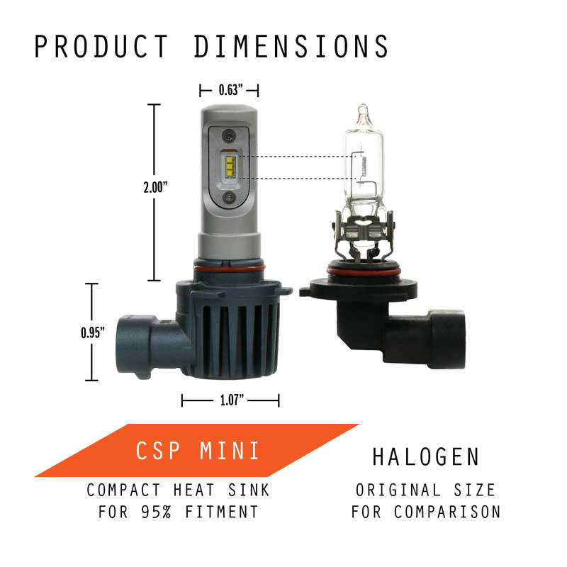

  6. LightCenterLength
    LightCenterLength New Member
    Feb 22, 2020
    US
    That phrase just goes to show how little the Chinese understand, or care, about the American regulatory system.
    Interesting that the chips are the same size and shape as the filament...of the numerous LED bulbs I've seen, none have even come close to matching the nominal diameter of a H11 bulb's filament. Perhaps yours are unique? If so, I would love to know where you got them...I'll be picking up a set for testing.
    Or perhaps you meant this below. I'm always perplexed why people think of bulbs as 2-dimensional objects, with only length and height. Things in real life generally are 3D, with not only length and width but also depth.
    #26 LightCenterLength, Feb 24, 2020
  7. ChapmanF
    28,637
    18,959
    Fair point—you're using a caliper, I was using my own personal eyeballs.
    In any case, they do have the position and volume a lot closer to that of the halogen bulb's filament than they used to in the early days, and it does appear to be close enough that I have a pleasingly uniform beam pattern with a pleasingly sharp cutoff right about where I expect it (where, again, I am eyeballing).
    This one is thicker across the LEDs than your example: .1838", or 4.67 mm.
    #27 ChapmanF, Feb 24, 2020
    Tim Jones likes this.
