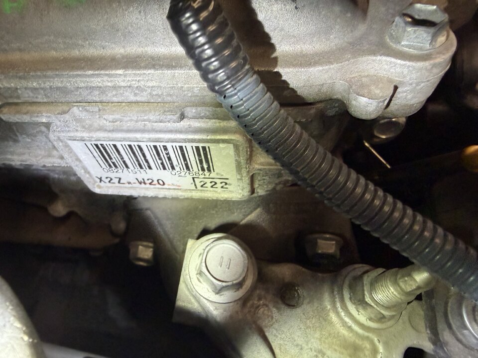

    Make sure its a JDM by verifying the engine tag and injectors are different.

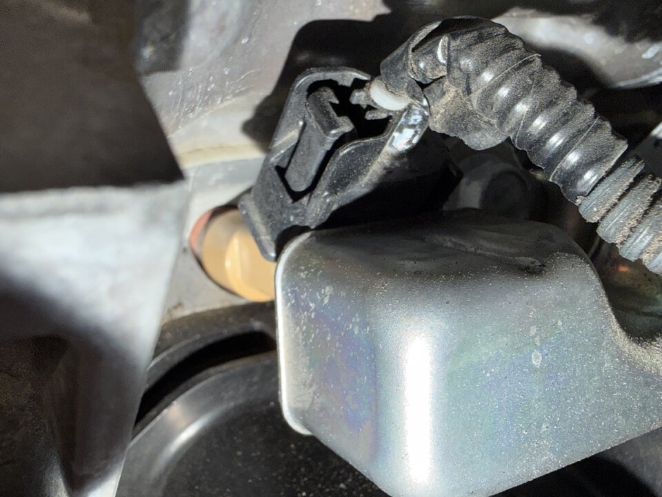

    Tan injectors
    X2ZR-W20 on the engine

    The used in Japan engine has a different model code and tan injectors. Many thousands used successfully in the US. Unknown differences but useful for identification vs US salvage. Some so called JDM engines are actually US salvage.
