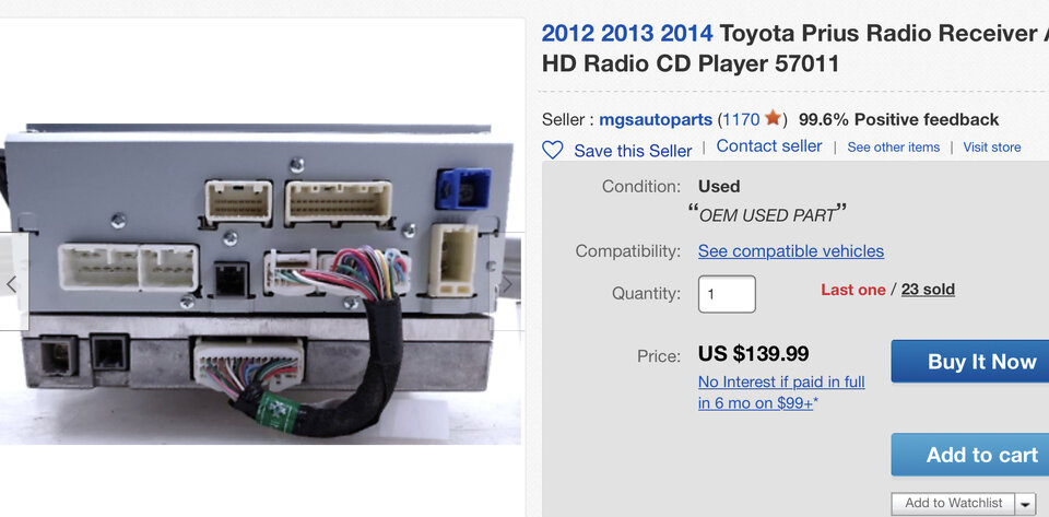

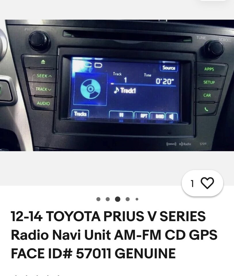

  11. rjparker
    rjparker Tu Humilde Sirviente
    Jun 6, 2008
    11,125
    6,980
    Texas Hill Country
    You buy them on ebay. Just make sure it includes the auxiliary box on bottom as well. The aux box provides bluetooth and navigation.
