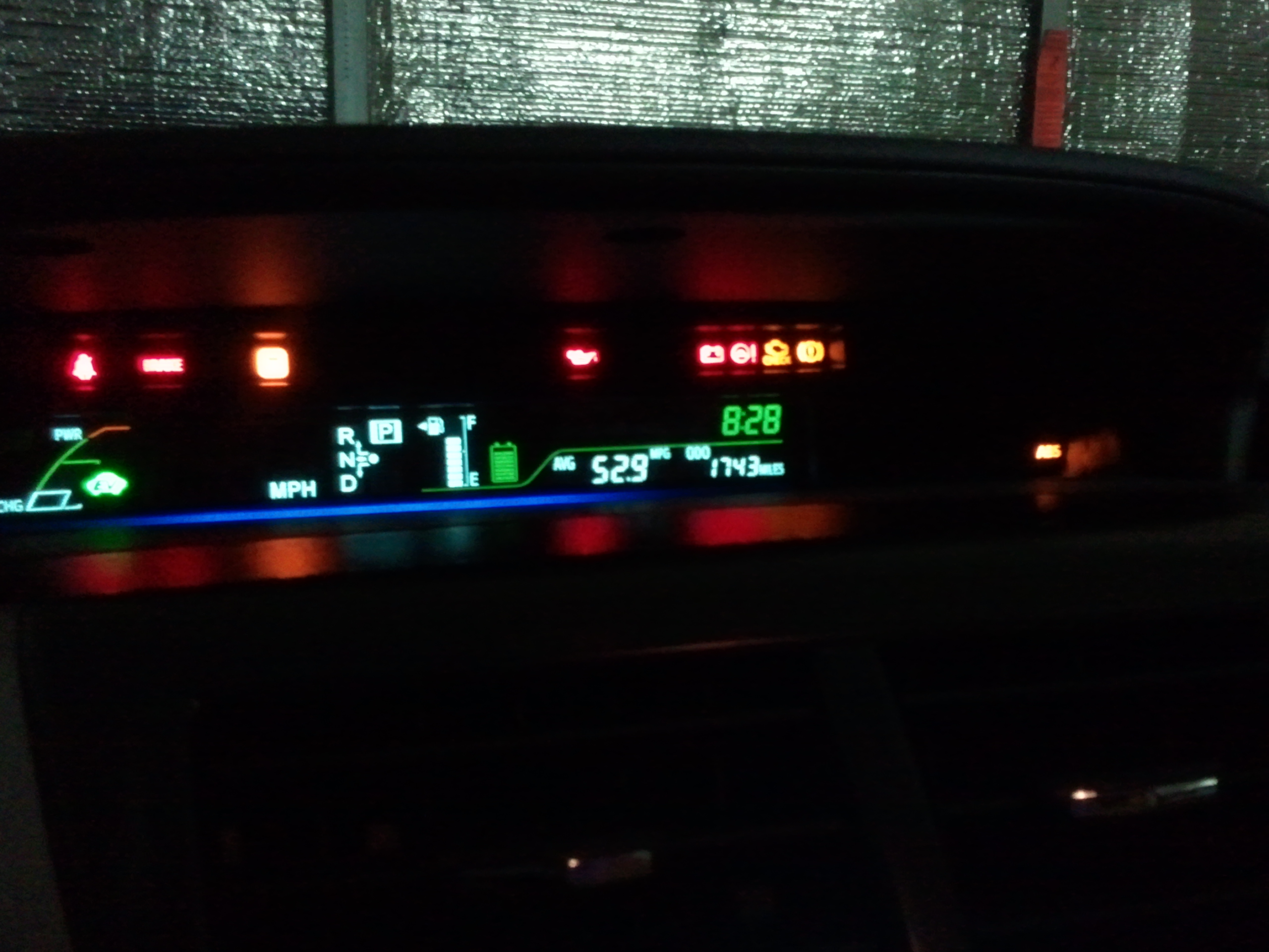

    I have over 30k miles on my 2012 Prius v (lowercase v for the Prius v wagon) wagon package 3. It never averaged better than 39 mpg here in the central coast of California where the weather is perfect year round and that is not accounting for the discrepancy in the speedometer accuracy, it is usually off by 3 mph going 75 mph. I drive it like a normal car, doing 75 mph on the highways. Mixed driving, mostly highway. I don't over inflate my stock tires for the sake of extra mpg, just what the factory recommends.
    51 mpg ?, I would seriously like to see proof of that many miles driven and the average, not what you got in the last trip down the hill , please show me the trip computer with those total miles driven, even on 1 or 2 tank full.

    Ok, here is the display pic, it only has 1743 miles and it is 52.9mpg. I drove the first 500+ miles and my wife is the regular driver. She drives about 60 miles roundtrip in urban to freeway to city to get to work. We're in Cypress NW Houston, so she takes hwy 290 to west loop into the Galleria area. It's not a particularly good drive now that road reconstruction/expansion is going on, 5-year project started in about 2012. But her route the speeds vary from 40-75mph, she typically drives less than 70mph on the freeway.
    I expect it should get better based on my experience with my gen II '06.

    I need to see the trip A or Trip B total mileage displayed with the average mpg, not with the ODOMETER mileage.
    52 mpg is pretty darn impressive though for a heavy wagon. the best we ever got is 39 mpg average. I have owned 3 2nd gen Priuses, by far they have always gotten 47-48 mpg at best.
