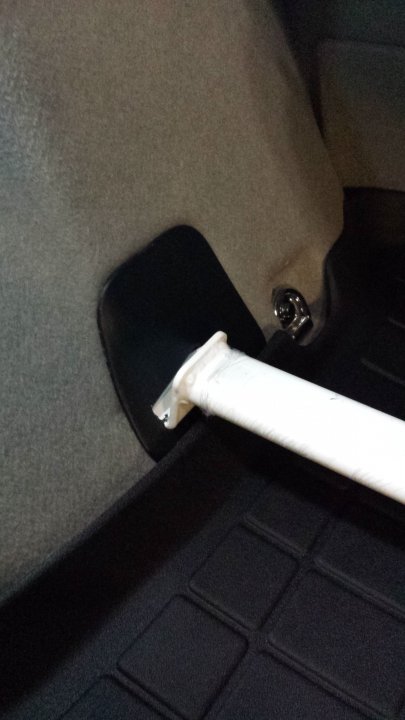

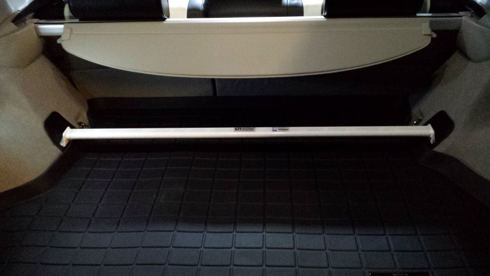

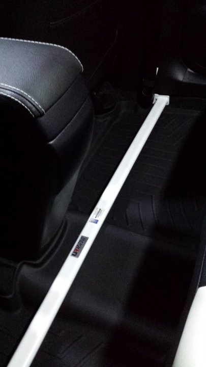

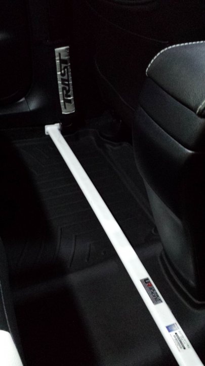

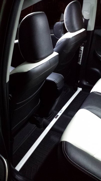

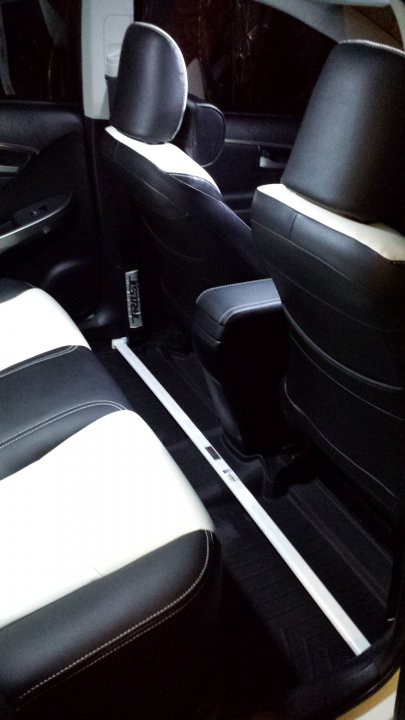

    There's always a difference after a suspension upgrade.
    Take turns with confidence without worrying about the car tipping over.
    Parts are straight bolt on and yes the rear floor bar attaches to the seatbelt bolt. It does not require cutting the carpet.
    However for the trunk brace, you will have to modify the shock/strut covers. Other than that it's also straight bolt on part.
    Enjoy

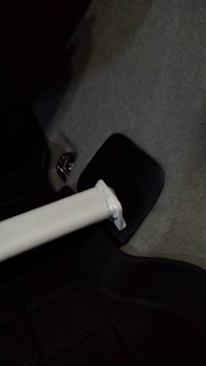

    I just got my ultra racing rear strut bar today. Did you place it on top of the top shock washer and then but another washer to go over the strut bar before putting the nut on?
  6. Xterra72
    Xterra72 Senior Member
    Oct 20, 2013
    1,437
    1,683
    I'm not sure what your second picture is but all I did was remove the shock nut, installed the ultra racing rear strut bar, and then reinstalled the nut.
    My mechanic recommended that a washer be installed on top of the Ultra racing rear strut bar before reinstalling the nut for added security.

    Perfect thanks. I picked up a washer for each side and some blue locktite to put on the threads as it looks like there was some on there from the factory. It looks a bit tricky to cut out a hole for the bar in the plastic cover. Any suggestions on making it look as nice as yours came out?
  8. Xterra72
    Oct 20, 2013
    1,437
    1,683
    @Dealeo, a friend from the forum had a used template that he was nice enough to hand over to me once he was done with it. I basically traced it over my covers and cut it to shape.
    The plastic is hard so it's not simple. Best thing to do is create a cover template off
    of cardboard and then trace the opening you need to clear the bar before making your final cut out of the actual covers.
    Good luck.
