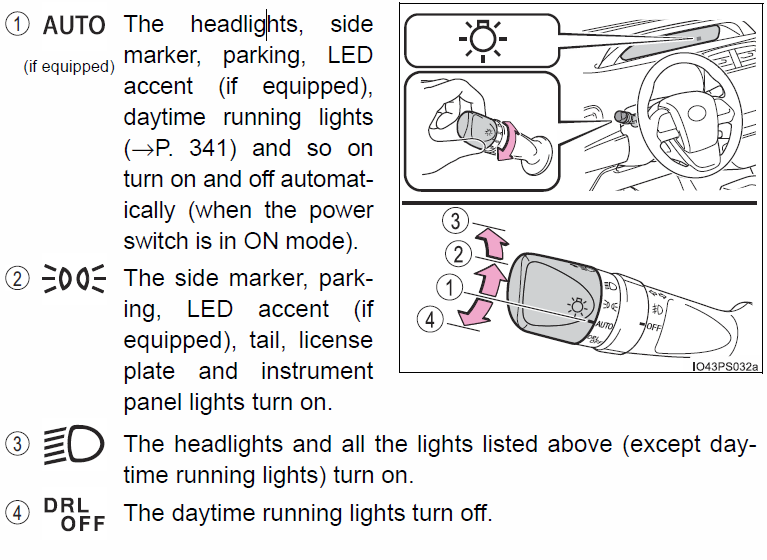

    He's confused that his tail lights aren't on, but his "brake" *not break* lights come on when he's in the parking light setting.
    Per this picture, they should be. Do your parking lights come on when you have full headlights turned on? If not, I'd start checking fuses.... granted all this assumes you have the AUTO slot on your stalk. My 2012 doesn't, but all other settings work as written.

    Possibly worth verifying which version of the headlight switch- ours isn't like the one pictured. I don't know if it's different because of the model year or because of the trim package.
