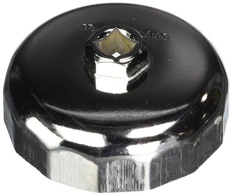

    Presuming the dimensions are the same as regular Prius oil filter: Honda automotive oil filter wrench works fine. Just google that, very easy to find. Our son's Mazda CX-5 filter is compatible too.
    It's just a basic, heavy gauge stamped steel socket, 14-face, slightly over 64 mm inside face-to-face:
    I don't understand the need for the extended side wall, slotted to match up with the stiffeners: a solution in search of a problem.
    I've done maybe 17 oil changes on our 2010 now, no problems.
    Check the dimensions of your oil filter with a caliper to confirm the outside face-to-face dimension, but I would bet it's 64 mm.
