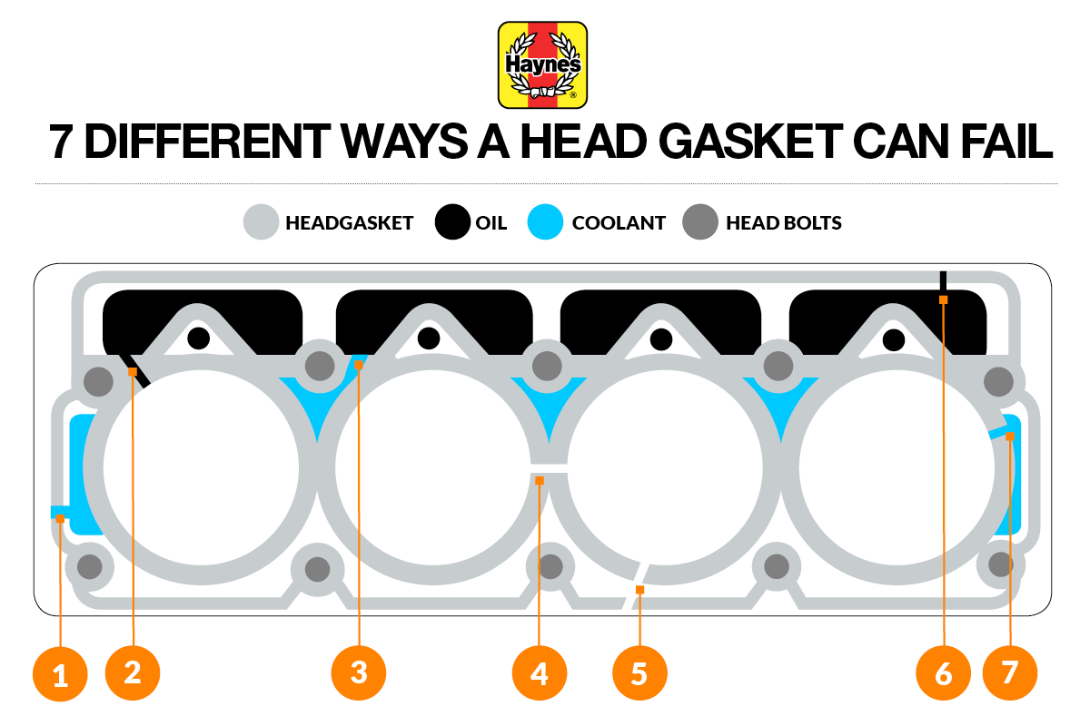

    There are 7 ways a head gasket can fail- clear oil just means it's not type 3 from this diagram:
    (Types 7 and 4 are most common in Prius engines)
    Gasket failure is fairly rare in the c model, but it isn't impossible- especially after an overheat. I'd be looking at the heat harvester for leaks. Get the system filled up and put a pressure tester on it. See if it will hold pressure overnight.
