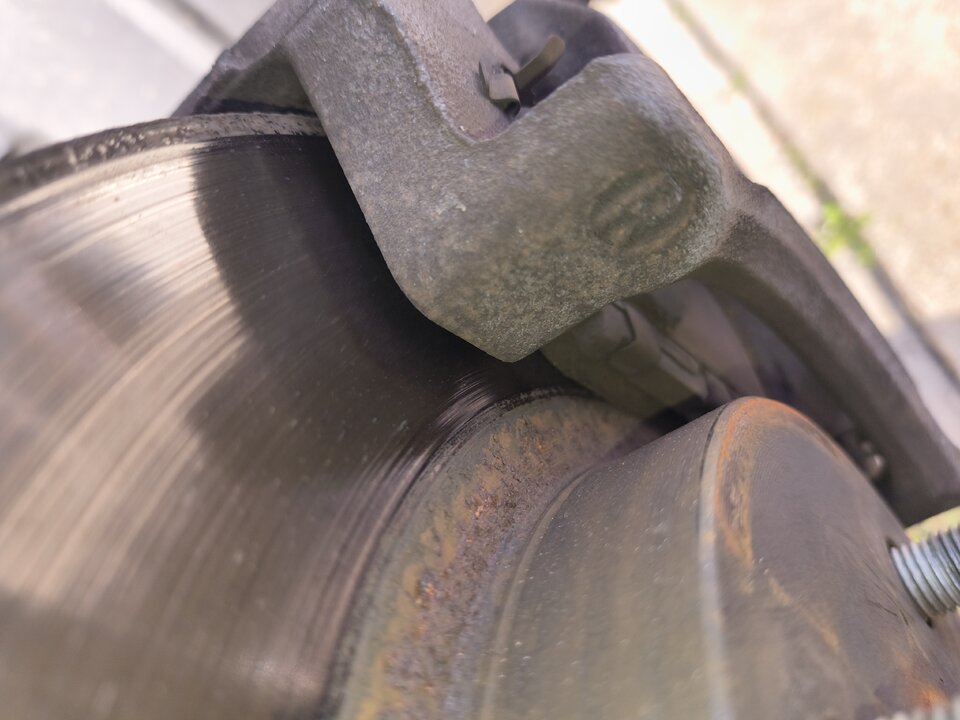

    Here are the best images I could get of the front brake pads without having the time to take off the tires.

    *edit* I noticed that the inspection report says the front brake pads are at 7mm, which according to the infallible chatgpt is plenty good until it gets to 3-4mm. I guess what I measured in the photos is not indicative of the lining thickness.

    the pads probably aren't touching the discs. you would need to get a look on the same plane as the disc.
