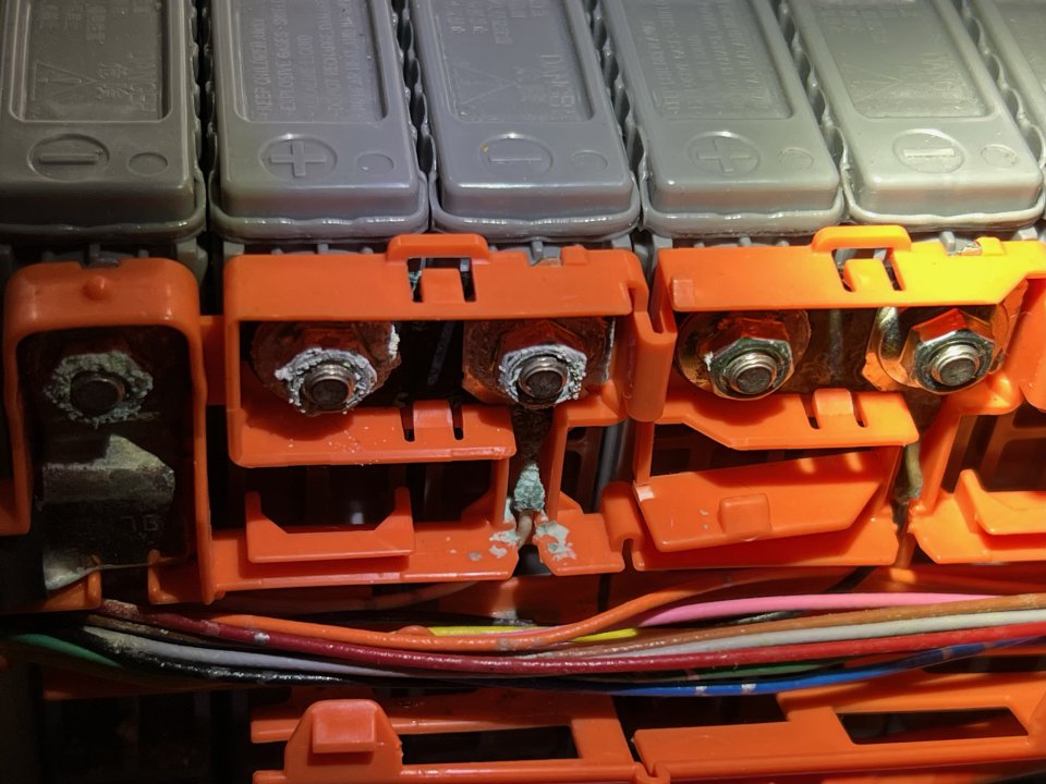

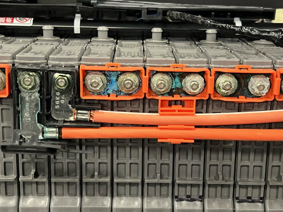

    Hi all, recently received a "Hybrid Battery System Failure" Alert on my vehicle which has about 70,000 miles on it.
    took it to the dealer for the $350 diagnostic and got a P0B51 error code "hybrid battery voltage sensor "E" circuit low". I am not entirely sure what happened, but next thing i know they are telling me i have a new $1000 charge to fix the voltage sensor. Final straw, they now want to replace the entire battery assembly for $4500, because the bus bars are corroded and that the battery warranty will not cover the repairs.
    Should i keep fighting to get it replaced under warranty (10 years/150,000 mile which toyota recently upgraded from 8yr/100,000miles) - since i believe it is a result of galvanic interaction b/n the copper bus bars and the stainless steel nuts and likely presence of battery fluid BUT they are saying is water damage? should i just tell them to replace existing battery as is and clean the corrosion from the busbars and sensor arrays myself/ at my local shop for time? OR should I bite the bullet and replace the battery?
    any and all advice welcome i included photos of the corrosion.

    My guess is that they can tell it is not original, because there should not be any black marker on any module.
    You are 100% incorrect with this statement. Anyone who works on these batteries will tell you the factory OEM modules frequently have marks on them like this.
    And for the OP, that corrosion on the sensing wires/tabs is 100% not from water damage. That is the exact corrosion seen on just about every single OEM battery after a few years of use. It's nothing unexpected. You may want to check the plug/socket on the voltage sensing module. It will often have corrosion buildup on the pins, which will cause codes.

    Agree with TMR-JWAP my battery has similar corrosion on bus bars and I know it didnt get wet. Mine isnt as bad but environment can be the cause, moisture in the air, etc. So are bus bars not part of the battery?
