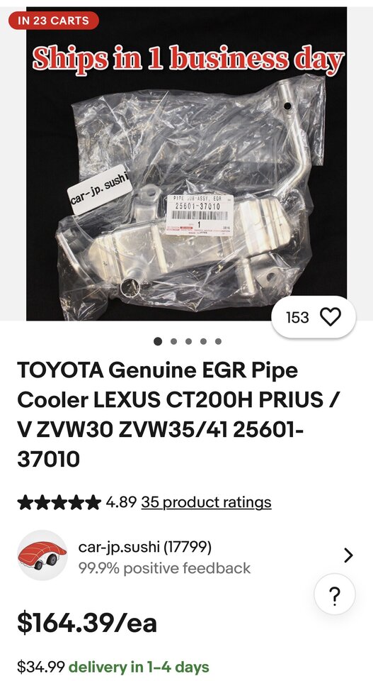

    You certainly have a hg leak. The misfire detection is not accurate on this hybrid when the transaxle damper is slipping. The rest of your symptoms match thousands of other gen3 hg failures.
    You don't want uncooled exhaust gasses straight into the intake and it would probably code. Blocking the egr path has been done and results in no real driveability problems but this will code as well. Perhaps a bigger problem than the code is the check engine light would always be on, potentially masking future issues.
    I would buy a new one. This new ebay unit is about $200 with quick delivery.

    1-4 day delivery?
  20. Mendel Leisk
    61,576
    42,364
    Typically a week to ten days for me.
