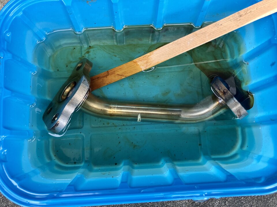

  5. Mendel Leisk
    61,578
    42,365
    This was 10% KOH solution by weight. The main object was cleaning out my dual oil catch cans, but since I had it off, thought I’d try it in the EGR pipe as well. 20% would be better I think.
    this was within a minute or so:

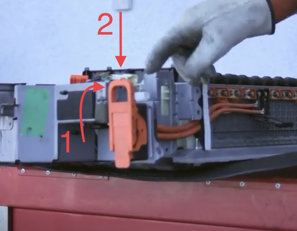

    Trying to start engine to evaluate the head gasket job and nothing other than a warning message to check the hybrid system? I disconnected the 12v battery for a while (actually charged the battery with the negative disconnected0 but when I reconnected no change. I had pulled the hybrid "fuse" during the engine project and reinstalled it, not sure if that is related.
    I'm sure it something simple but what?
  9. rjparker
    rjparker Tu Humilde Sirviente
    Jun 6, 2008
    11,125
    6,981
    Texas Hill Country
    Normally the orange hybrid disconnect is just pushed in but not slid closed to engage. Prius battery hv disconnect.jpeg

    Okay, engine started (not sure what I may have done other than I did engage the hybrid system key) but still have the hybrid system warning message? With the engine running it shows the hybrid battery at about 90% charged with power going from the engine to the battery (as expected).
    I don't have the cowl panel and the wiper parts in place so I can check for coolant leaks but also can not drive it anywhere at this point.
    I was hoping to run it long enough to get the thermostat to open but it shuts off so I guess I need to put the panel and wiper parts in place to be able to drive it. I'm not sure what to do about the Hybrid system warning as there was no problem prior to the engine work being done.
