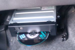

    I've seen many navigation dvds for sale on ebay for Prius as shown by attached images, also I've found an image showing a dvd drive located under the drivers seat. The problem is that I cannot find a dvd drive under the driver's seat!

    maybe those are older vehicles. why not ask your dealer?
