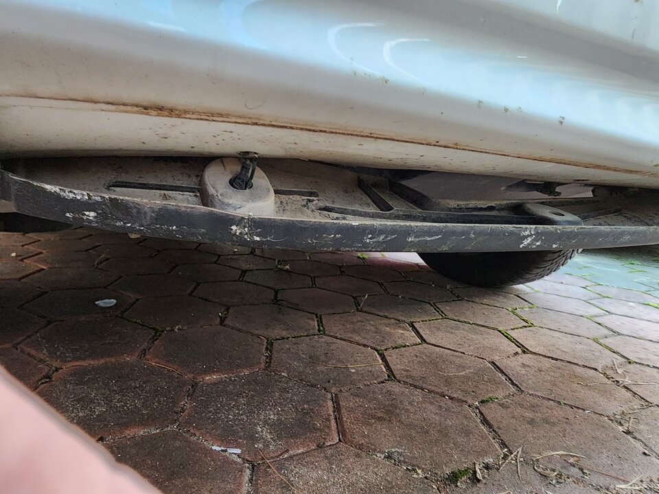

    I accidentally backed my 2013 Prius Plug-In into a fence and had some minor damage. The rear undercarriage is hanging down a bit (pic attached). Is there a way to repair this or do I need to replace?

    As for repairs, you simply replace the clips that busted, very easy. Of course because no one is going to see the underside of the car you can also skip spending money on clips and grab some screws and a screwdriver gun and screw new fasteners through the plastic to hold it all together and call it done in less than 5 minutes.

    Good to know that it's a relatively simple fix for the clips. Thanks! Now to get the car back on...
