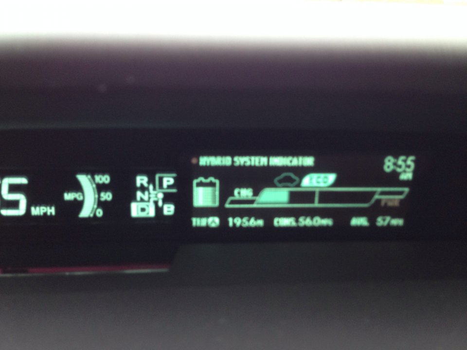

    Seems as though ECO is to the left of the center line, normal is to the right (Eco light goes out) and power is the red zone beyond that when the pedal is further depressed matter which "mode" is selected. The more I drive it and observe this the more I think this whole discussion is purely accademic.

    When I look at that green picture, showing Motive Force Output (ICE+motor response) vs. Accelerator Pedal Opening, I translate it as saying:
    PWR mode = the computer "responds" more (a) quickly (ie: above the blue NORMAL line) and (b) aggressively (hump) in middle of pedal opening/depression in response to the drivers' NORMAL foot-pedal movement.
    ECO mode = the computer "responds" more (a) slowly (ie: below the blue NORMAL line) and (b) laggardly across the whole pedal opening/depression in response to the drivers' NORAML foot-pedal movement.
    NORMAL mode = the computer "responds" uniformly (ie: NO enhancement, NO suppression) across pedal opening/depression in response to the drivers' NORMAL foot-pedal movement.
    To me, it's saying *how* the computer 'changes/interprets/responds' differently to the drivers' pedal depression readings that it receives from the 'Accelerator Pedal Sensor' for each mode.
