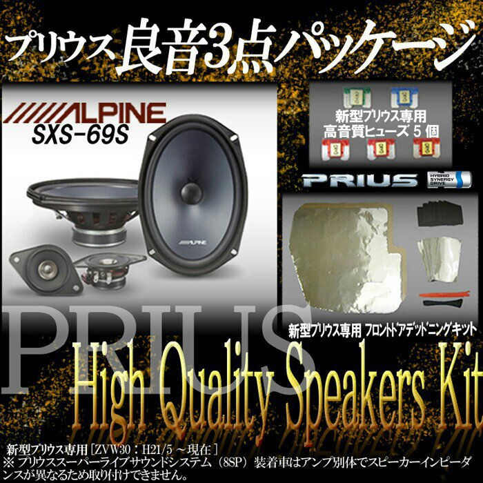

    Another much simple way is order the Alpine special speaker kit custom for Prius 3 without JBL :
    So no special bracket is needed.
    With this kit and sound damping, il will be quite enough for an Audio beginner. And if it is not good as expected, add a slim Subwoofer.

    Is the above genuine alpine???
  8. Hortevin
    Hortevin Junior Member
    Dec 10, 2013
    16
    I don't understand your question?
    It is an Alpine genuine product made for Prius 3...
  9. Skunkworks
    Skunkworks Member
    Jul 5, 2013
    101
    The question was, did Alpine manufacture a vehicle specific upgrade for the prius? I called Alpine, they don't manufacture such an item.
