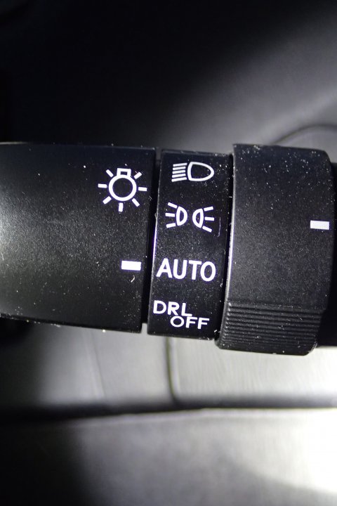

    Just bought a 2013 Plug In Advanced. (I guess they only come in two trim levels, the Basic and Advanced) My lights seem to be a bit different than what I've seen here. The light stalk on the steering wheel has:
    • Headlights
    • Parking Lights
    • Auto
    • DRL Off
    When set to Auto, the DRLs only come on in the daytime, automatically. At night, the DRLs go off, and the parking lights, headlights, eyebrows and the fog lights (when the fog light switch is on), come on, once again, automatically (yes, this Prius has LED EYEBROWS!). The sensor for the automatic lights is on top of the right side of the dash. When set to Parking Lights, the parking lights, the daytime running lights and the eyebrows all come on, whether it is day or night. When set to Headlights, all parking lights, headlights, eyebrows and fog lights (when fog light switch is on) come on, but no DRLs.

    Headlight Stalk, 2013 Prius Plug In Advanced, United States

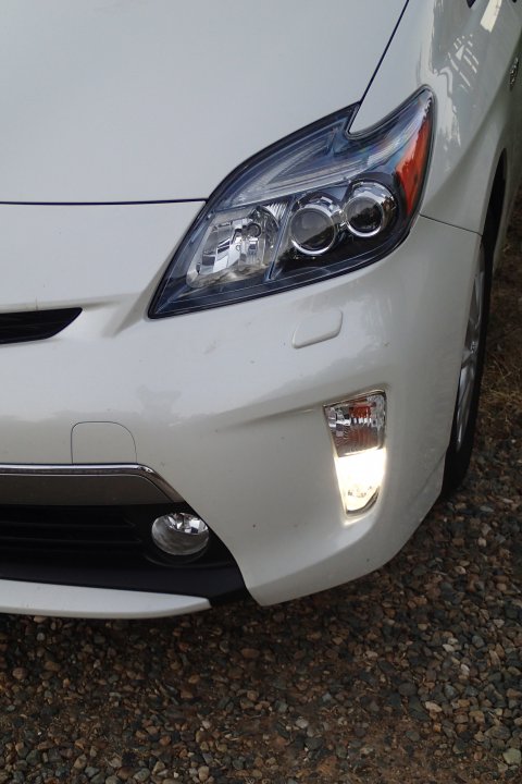

    DRLs, (Daytime Auto Mode), 2013 Prius Plug In Advanced, United States

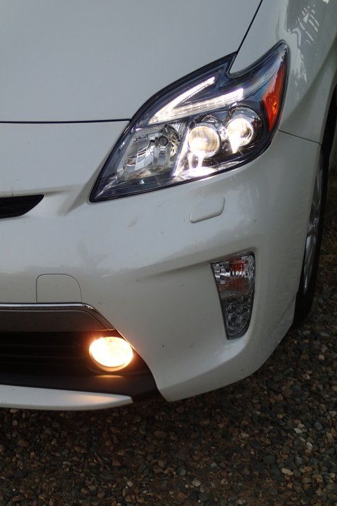

    Low beam headlights, eyebrows and fog lights, (Nighttime Auto Mode),

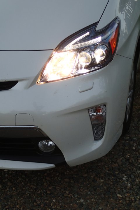

    High beam headlights and eyebrows, (Nighttime Auto Mode; note that the fog lights go off),

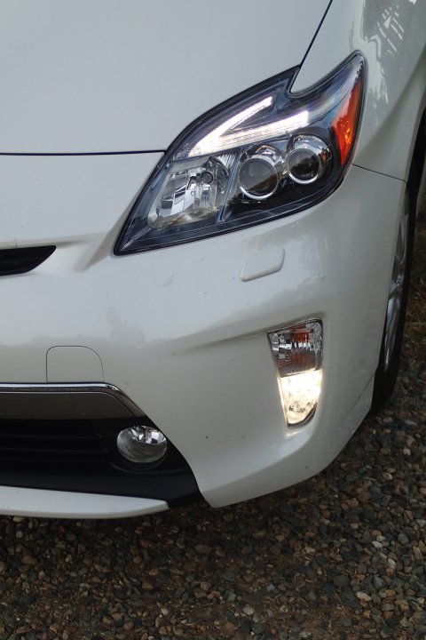

    Eyebrows and DRLs, (Parking Lights Mode; it looks like this day or night),
