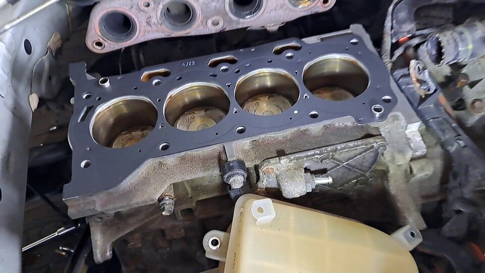

    This is the head gasket I installed in my prius, a 2012 prius v with 231k miles, from 04112-37254 kit
    This is the head gasket I installed in another prius, a 2013 prius v with almost 212k miles, from another 04112-37254 kit.

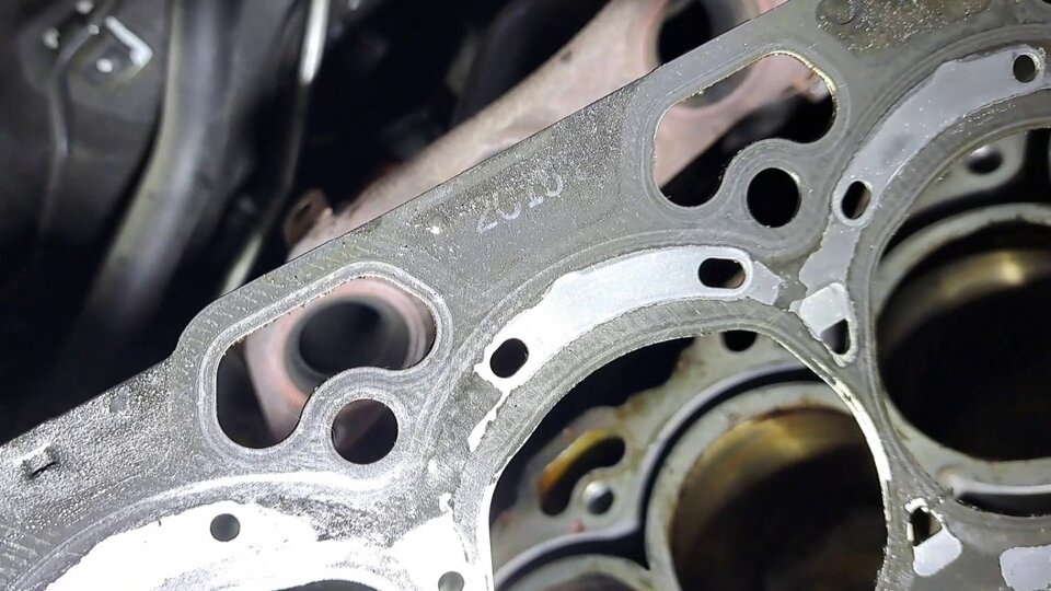

    This is the head gasket i removed from my prius, a 2012 prius v with 231k miles.
    I'm wondering what those numbers on top of the gasket mean? I searched online and found numbers that matched mine from the kit. There is also a number that starts from 8.
    I'll stop by the Toyota dealer one day and ask about the updated head gasket.

    That looks like the updated one, per The Car Care Nut's video:
    Starts at the relevant point. I'm not that sure about his "reason" for the failure, but as you say, for another discussion.
    It'd be good to know the part no for the one in the video. I asked the question, in the comments.
    Does the gasket kit not disclose part numbers of the content? Frustrating.

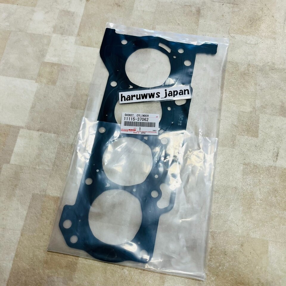

    According to the Toyota dealer website, the latest cylinder head gasket part number is 11115-37062.
    11115-37062 - Head Gasket 2008-2022 Toyota | Longo Toyota Parts
    I'll talk to my local Toyota parts department. We'll see what they say.

    I stopped by the dealer and asked about the latest part number for the cylinder head gasket for the 2012 Prius. I asked him to tell me the number so that I could compare it with the one I had, and it was 11115-37062. Then he asked me for the vin number of the car to try another way. I gave him the vin # for 2015 Prius and the computer gave him the same gasket number 11115-37062.
    I asked him if he could find a list of gasket numbers from the 04112-37254 kit. He couldn't find it.
    I think that for such information you need to contact the Toyota corporation itself.
