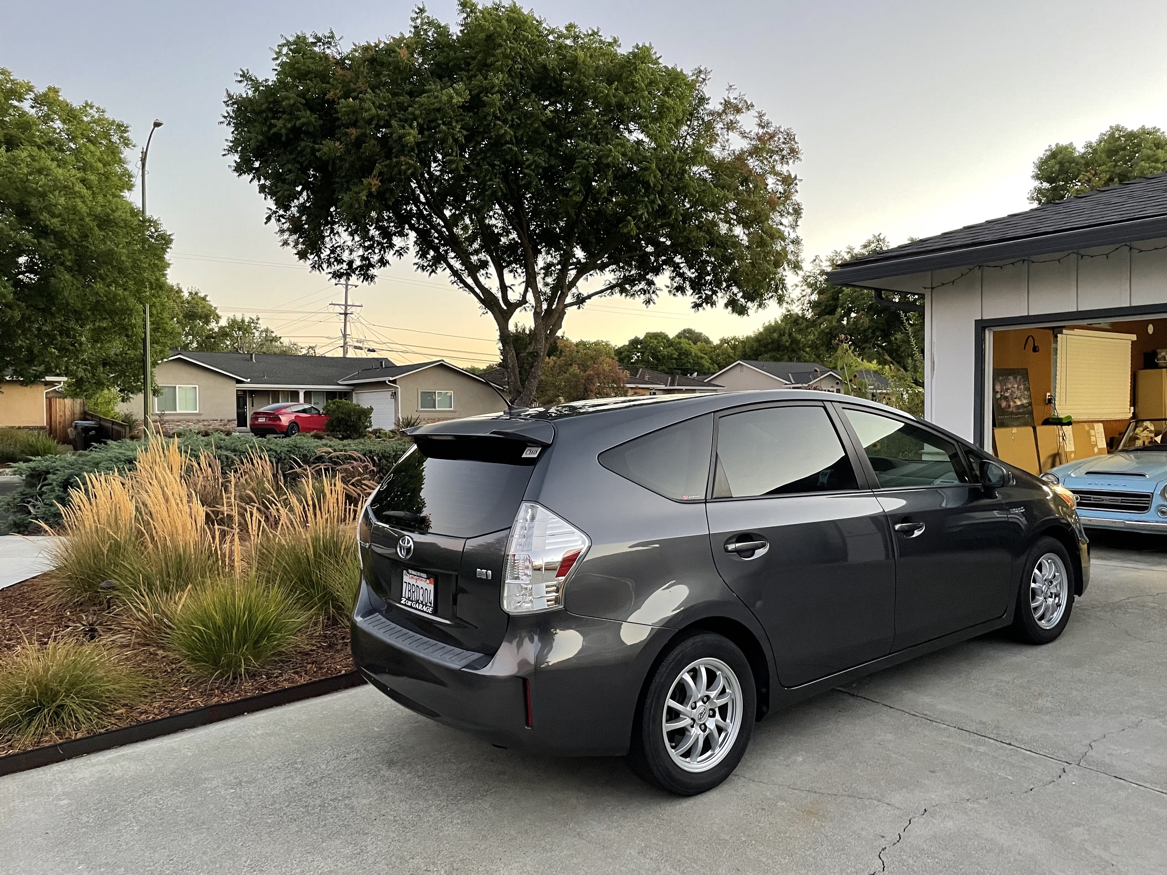

    ps here is a photo of our Prius...we had great times with it:

    Thank you for the input! Was not aware of Gasket Masters and checked out there website.
    I'm not one to shy away from making money, but I'm skeptical about the repair costs. Also not keen on the time it takes to deal with it. Let's say Manteca is my only hope at getting the HG fixed...I need to ship it there (80 miles). Then it's anybody's guess what else could be wrong in addition to HG, water pump? Brake booster? No idea. But this forum has definitely put the scare into me about the V's issues. :)
    Your suggestions give me something to research further. I just finished detailing her this evening, enjoy!

    Wow, very clean! (very nice fairlady too!) Your post wasn't showing up earlier but that V is worth way more than $3,500 as is which makes the dealership's $2,500 downright crazy.
