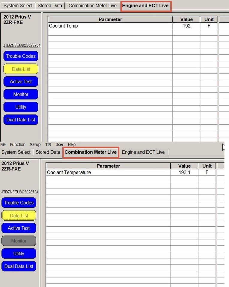

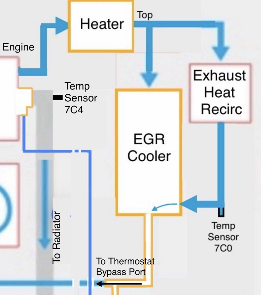

    Monitoring both coolant temps with a scanner like Techstream or an app like Car Scanner can help diagnose the first scenario.

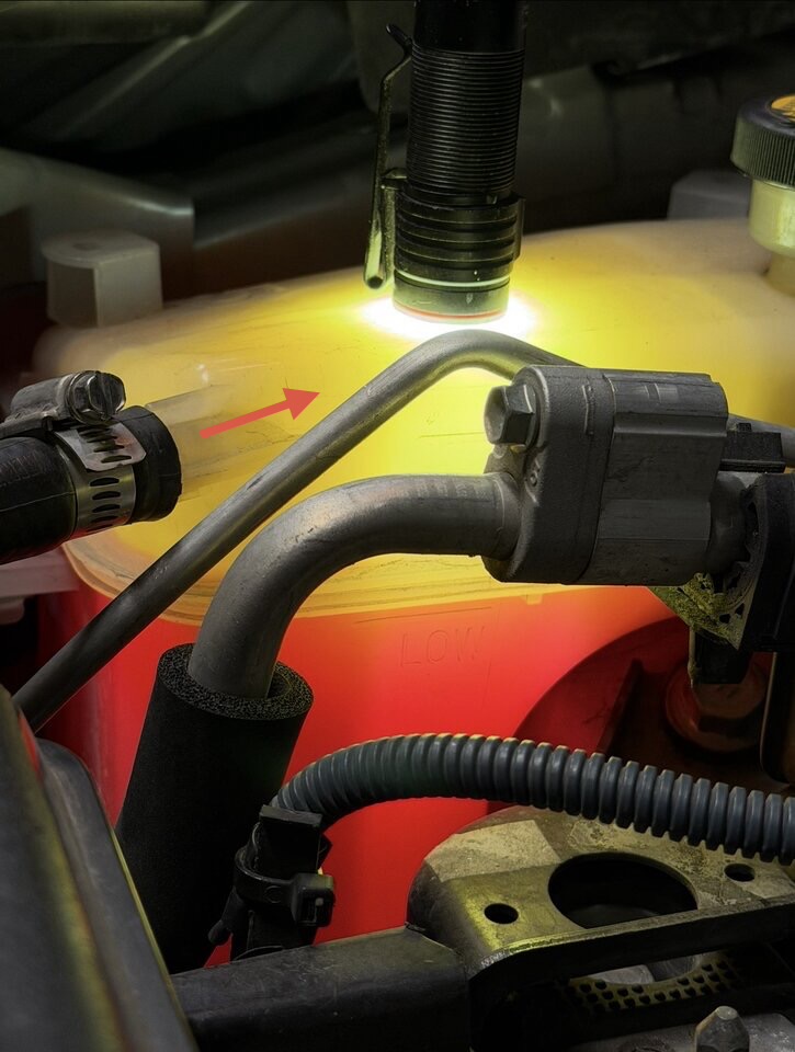

    After warmup water flow can be seen here

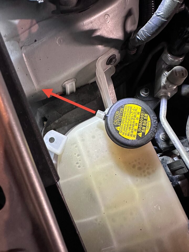

    If the coolant overheats, this pressure cap releases coolant
    Techstream scanner with both Coolant Temps, one in Combination Meter ecu

    Two coolant temps on engine

    You can see flow in the reservoir as shown above when the thermostat opens.
