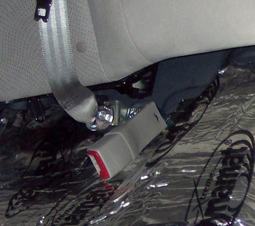

    Is this the bolt? I gotta believe it removes counter-clockwise but it's probably on really tight. Make sure you have a sturdy socket wrench with an extension. Maybe putting a short metal pipe over the socket wrench handle would give you more leverage to break it free.

    Pay attention to the arrow of the seat belt buckle before you remove it.
    IIRC it takes a 14mm socket and comes right out. I have a 13" long snap-on ratchet and it broke the bolt loose no prob.

    Lock tight helps keep the bolt tight after you re bolt it down. I've personally installed over 50 prius, clazzio seat cover kits, and I've never had an issue getting that bolt undone. I see this post is a few weeks old, I hope you've resolved it by now? The install process is pretty simple here, unbolt the seat belt from the frame, poke the seat belt through the clazzio cover, then revolt the seat belt back the frame. You should be able to get a good tight fit on the bolt without ever having to use lock tight, but like someone else said, if you wanted to add it, it wouldn't hurt anything.
