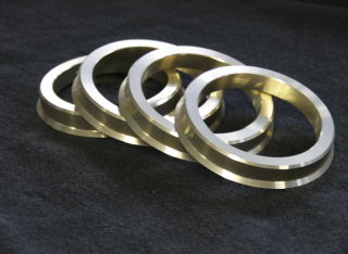

    These ↓ and cheap 5mm, 5x100 , 56.1 spacers should work except for the lug engagement question:
    Hub Rings Configuration - Complete!
    2010 TOYOTA PRIUS
    Your Bolt Pattern: 5x100mm
    Your Hub Diameter: 54.1mm
    Center Bore: 56.1mm
    Quantity: 4
    The price for the above configuration (before tax and shipping) is $100.00. Tax and shipping will be included in your total on the Payment Configuration page.
    jpsdrivesfast likes this.

    This may be what we need:
    Spacer Configuration - Complete!
    2010 TOYOTA PRIUS
    Type: Spacer
    Hub Centric to Car & Wheel Centric to Wheel
    Thickness: 5mm
    Center Bore: 56.1mm
    Quantity: 4
    The price for the above configuration (before tax and shipping) is $140.00. Tax and shipping will be included in your total on the Payment Configuration page.
    Fire, ask about what they recommend doing with the lug nut engagement issue,
    and we still need to figure if 5mm is enough with new brake pads installed, Thanks, Bill
