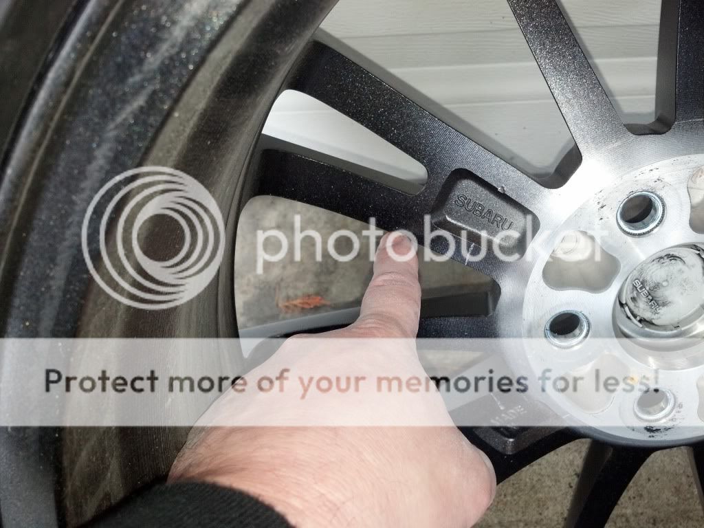

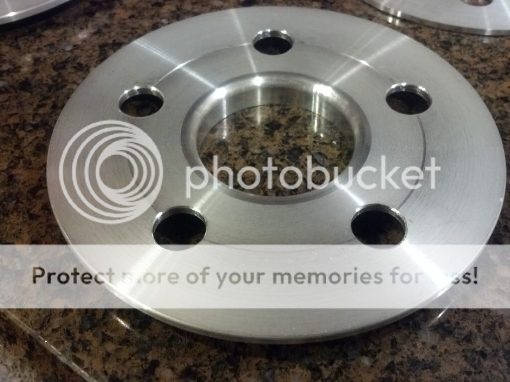

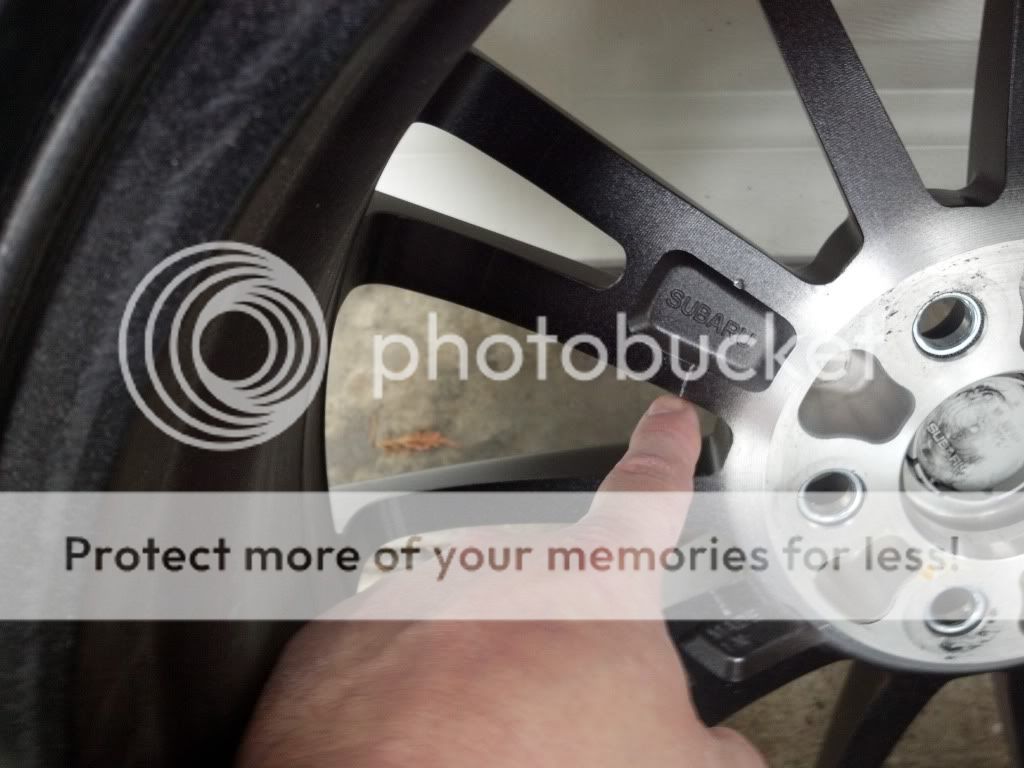

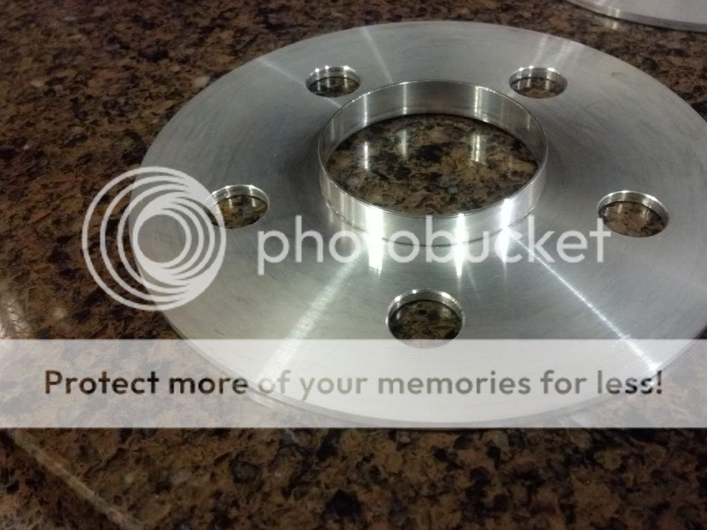

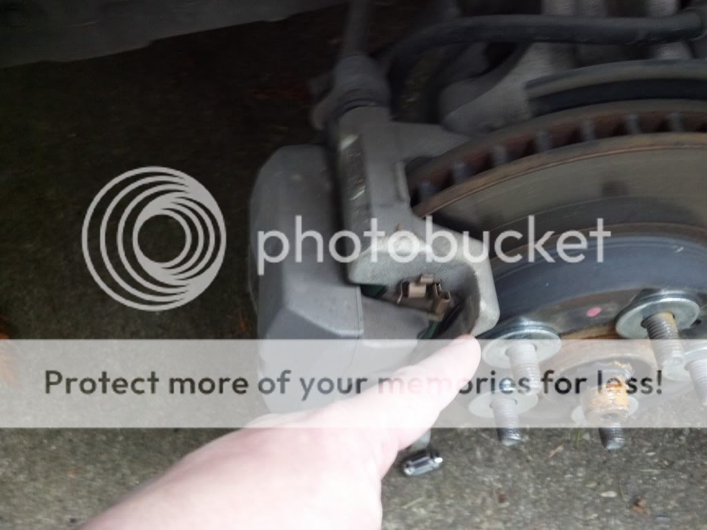

    Alright all you FRS wheel fans. I'm going to include a few pics with notes. Hopefully I format it correctly. I ordered the spacers from motorsport-tech.com. They are 3mm spacers that fit the 54.1mm hub. They step up to a 56.1mm hub for the new wheels. They are hub-centric to the original hub and that centricity is carried to the new 56.1 dimension. They are made out of Alcoa 6061 t6 billet aluminum. The new 56.1mm hub portion protrudes 10mm so it will positively engage the new wheel (I made sure the protrusion was tall enough because the FRS wheel, and many others, have a taper for the first few mm's of the hole. I spoke to the owner, Leonard, and he said they would machine them today for me and mail them so I would have them by Friday. Cost was $140. More than most generic spacers but they are made in Sparks, Nevada and it was nice to call and talk to the person who knows what I want and how to answer questions.
    OK here we go. First pic below. To answer a question from a previous poster about pad wear and the possibility of the caliper touching when new pads are installed. This shouldn't be an issue. You can see the contact marks on the first picture......this is from the caliper mount (shown in second pic) which is fixed. This is the object that the new spacers are needed to clear. With the new spacers it leaves us with 2mm clearance. The caliper itself, the only part that floats in and out, is further from the center point of the wheel and as such is further into the arc of the spokes which leaves tons of room. The third pic shows me pointing the portion of the spoke that the caliper is lined up with. The spoke arcs out drastically here which leaves lots of clearance.
    Hope some of this helps. I will have the spacers on Friday hopefully and will install them. I'll post pics with results shortly after. I thought about going to a 4mm spacer but with the 3mm I am already losing a few threads for the lug nuts to engage. With the 3mm spacer I am still getting 6 turns of engagement which is a word of mouth industry minimum standard.....I feel more than comfortable with that. Going to the 4mm would drop you to around 5 turns for the lug nuts......still probably ok but if the 3mm works fine then why bother.

    Oh, and BTW, from the detailed pics and report you posted, instead of spacers,,
    I'm considering using a fine sanding disc on a high speed and blending out ~ 3 mm from that corner of the caliper carrier.
    That thin joining bridge from the top slide area to the bottom one is there to resist spreading of the top and bottom of the carrier. In use that lower slide area takes all the torque of braking while going forward.
    I'll post detailed pics of this modification to the caliper carrier with before and after measurements.
    Call me crazy, but I believe that cast/forged steel piece won't miss a blended out 3-4mm....

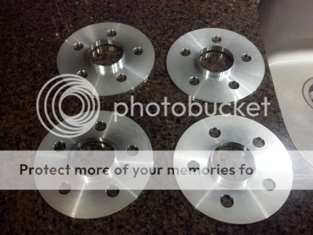

    Here are pics of the new spacers. They did a good job on the machine work........I double checked the measurements with calipers. Spacers are 3.5mm thick. [​IMG]
    F8L and exbauer like this.
  13. exbauer
    exbauer Active Member
    Aug 16, 2006
    1,188
    102
    Washington
    Those look like some good quality spacers. I was worried about the center ring and keeping the wheels centered. But, these will definitely keep them centered and cause less wear and tear on the studs.
