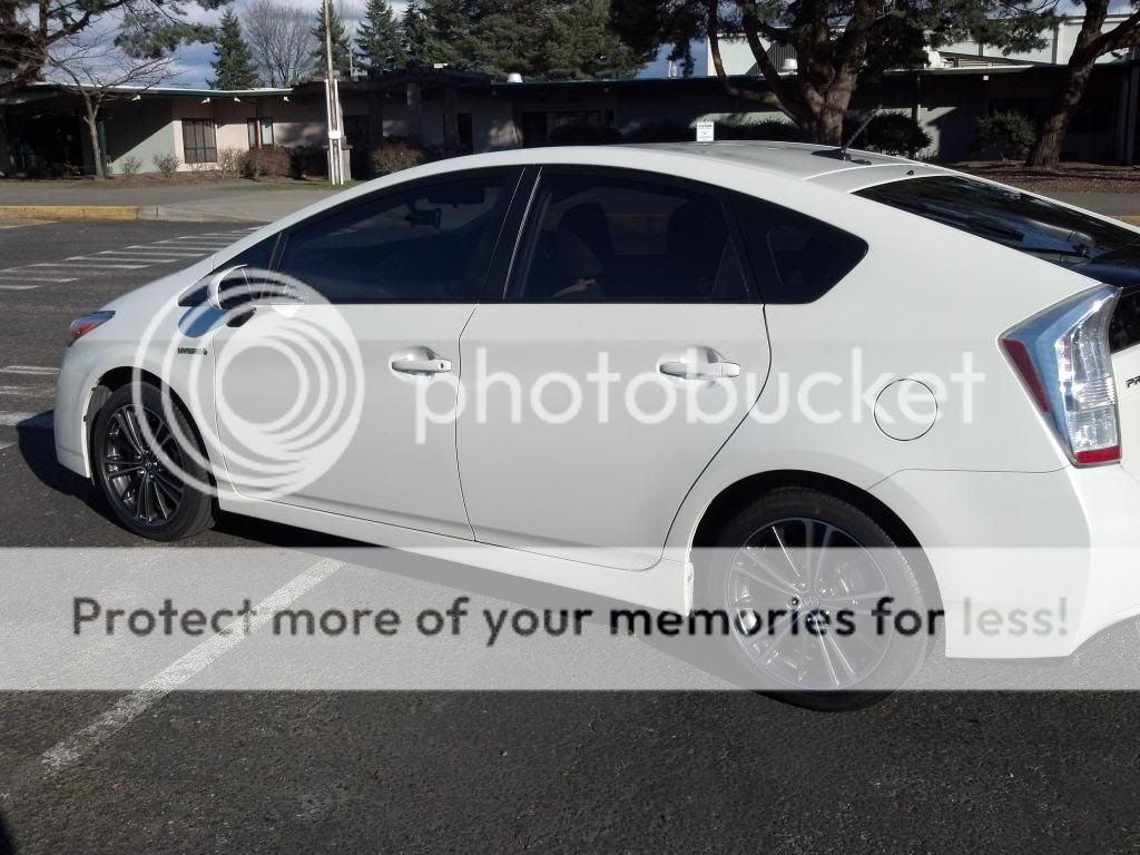

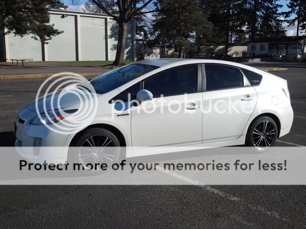

    Hello, so how's everyones setup holding up? Thinking about picking up a pair of FRS wheels too but still not sure what direction I should go as far as spacers.

    Looking good! H & R makes wheels spacers in many sizes.

    Those wheels look great! I'm about to put those same wheels on my Prius but I wanted to know whether or not I'll need to change out the studs and get spacers. Thanks!

    a 3mm spacer is needed to clear the calipers (they will hit them) and a centric ring that goes from 54.1 to 56.1 for the wheels to be centered and wear evenly.
    I got a custom plate made to have both and ordered mine from here. A cheaper alternative is to just get both separately.
    Then need to get an alignment to make sure everything is squared away. If yours dont have the TPMS censors, go to Firestone for cheap. Dealerships may rip you off for it.
    hope this helps!
