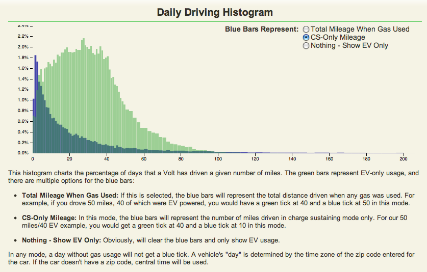

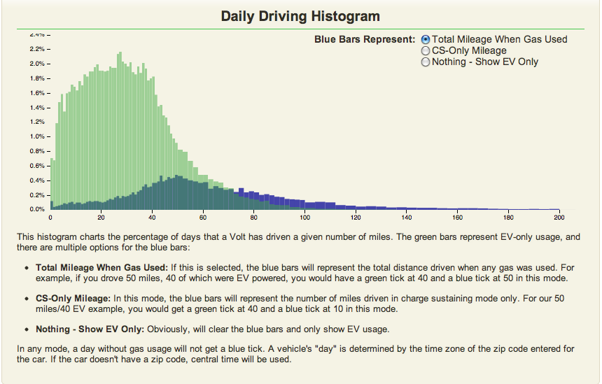

    Sorry I forgot to provide data.. here you go
    In this this daily driving graph from voltstat.net, a green bar is a day with NO gas, and the blue ones are total distance on days using gas. Note the blue days will have some EV, with the amount depending on the drivers and charging. Here is a plot showing just how much CS was actually used
    The vast majority of the graph is green, supporting my statement that 150mpg.. in fact any finte MPG, is a bad day for volt owners. yeah there are some people that use gas a lot, and some for whom a PHV would be more efficient, but probably very few.
