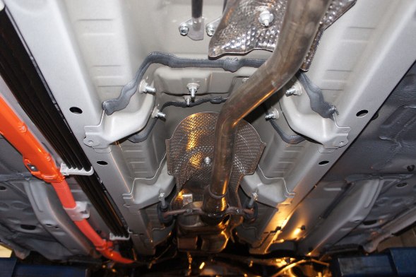

    The first thing I'd put on any Prius"c" would be the center mid-chassis underbrace.
    None is installed on any "c" as shown in the attached photos.

    I bought that off eBay. Didn't notice a thing. Not to say I'd rather not have it but yeah.

    Quoted from another thread on the Gen III under brace.

    Different car and a horrible explanation. The crosswind sway has A LOT to do with soft, narrow, large sidewall tires mixed with soft suspension and a light weight car. Either way I bought your mid brace and would do it again. The more braces the better imo.
