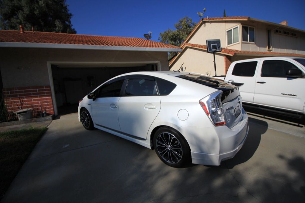

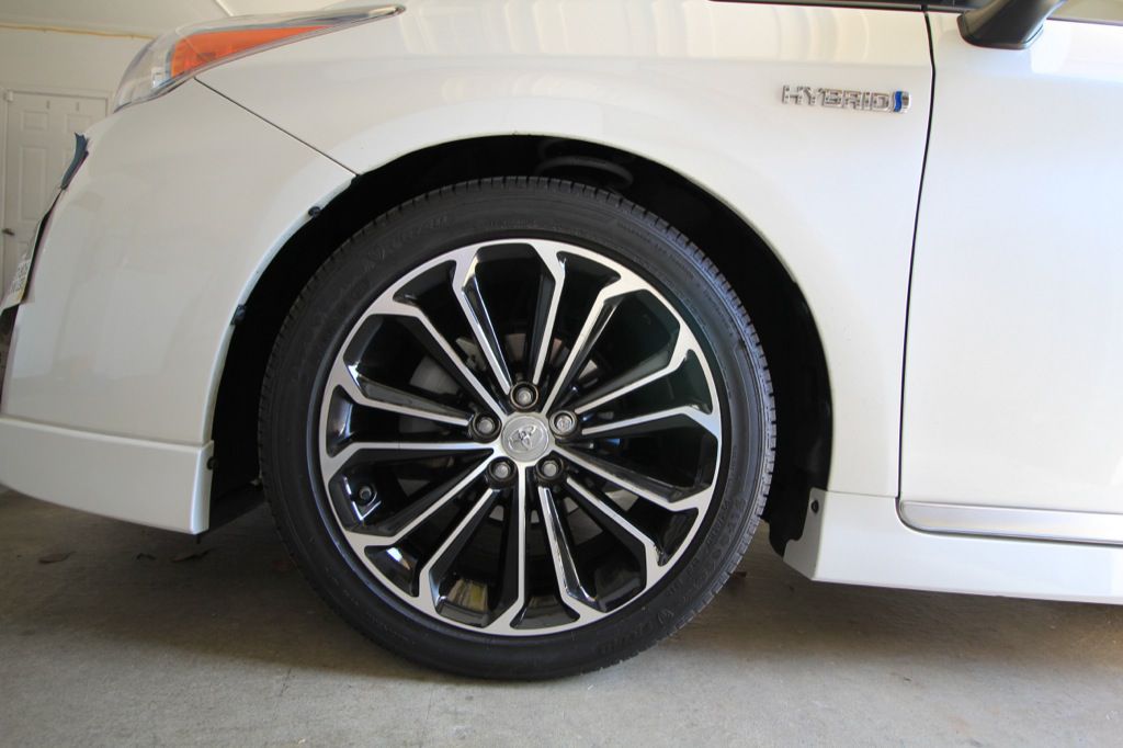

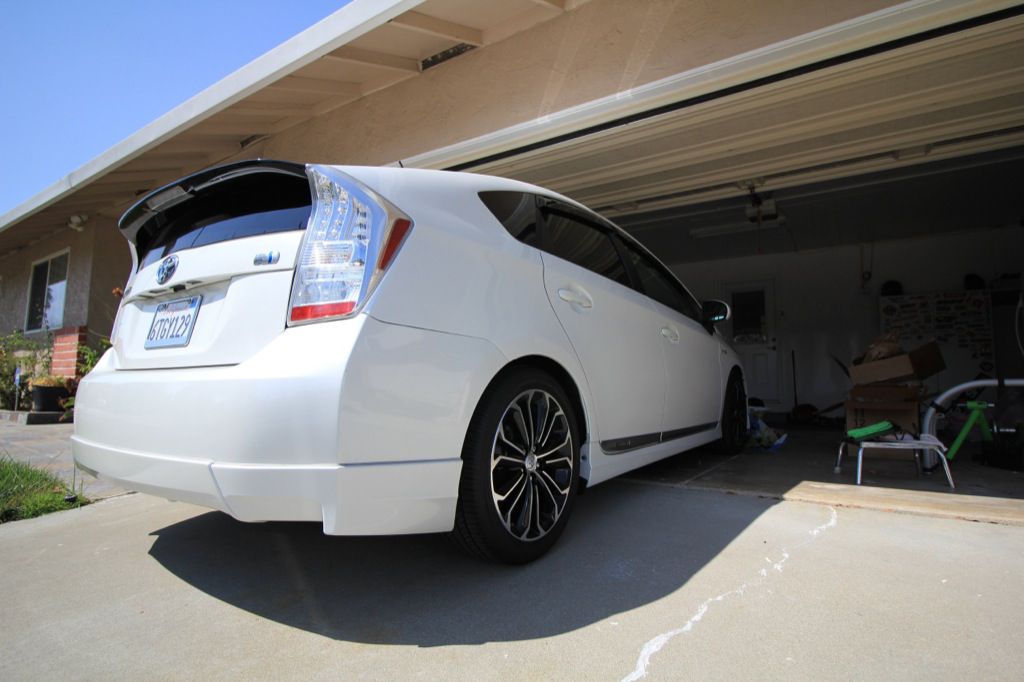

    I don't think anyone has done this yet. But I did today! It started with me deciding between aftermarket wheels and the FRS/BRZ wheels.
    But the Corolla S wheels have all the advantages we all wanted:
    +54.1 center bore (no need for hub centric rings)
    +Toyota wheel caps
    +No need for spacers (frs wheels brake clearance)
    +Uses stock lugnuts (Aftermarket wheels uses different lug nuts, Prius Plus wheels and FRS wheels does too)
    +It's 39mm offset with no rubbing!
    And personally I think this looks wayyyy better than the FRS wheels, but I am guessing they are a bit heavier.
    The specs are: 5x100, 17x7, 54.1 bore, 39mm. Wheels are made by Enkei. Toyota part number is: 42611-02G20

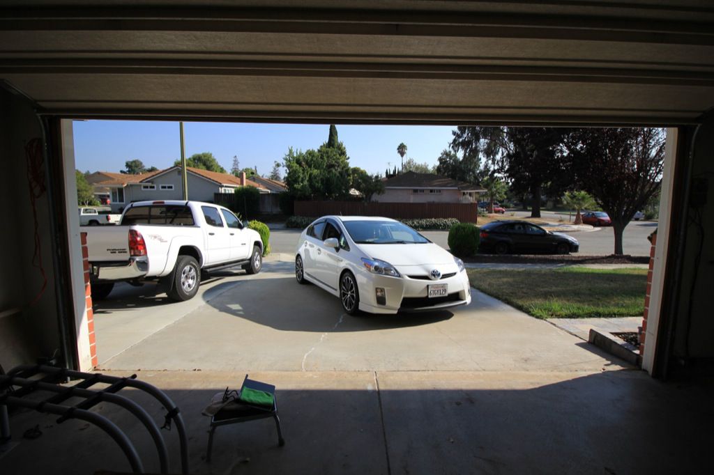

    Here are the photos, (I also installed the 2011 Prius Plus ground effects kit and the springs today, it was a really long day.) Tell me what you guys think :)
    Updated with more pics! 9/6/2014
