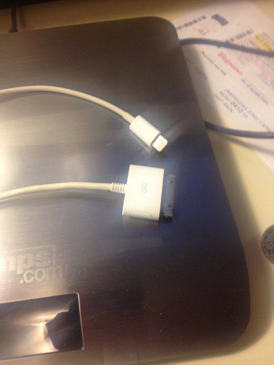

    I think I made the same mistake...when Erin said "I just plugged it into power", I think she meant the iphone was plugged into a car charger thru cigarette lighter receptacle. That's exactly what I did and got the "connection failed" message. Once I got my iphone cable (the one with USB on one end and 30 pin connector for 4s or lightning connector for 5s or c (in photo img_992.jpg...the upper one is the lightning connector and lower one 30 pin. Once I connected the iphone that cable, it worked!!! Could get fuel prices, poi's etc. It's inconvenient BC you have to hard connect your phone...and you might forget and leave it in your car which could make your iphone shutdown because of high temperature! Wireless hotspot won't work either, bc the Toyota system's wireless communications is via bluetooth (at least I couldn't find mention of wifit in either instruction book.) I agonized over this since we bought the Prius. Great car though! ECO display is good! Help keep the MPG high (40+) Being in California, one can't drive slow, else you get run over. I'll goose it until it gets up to speed limit and then back off to get the ECO light to come on. Well, 'nuff said this thread. Thanks for this thread and to Erin, DaneH5 and FTI Explicator for the hints! Sorry for the diatribe, but I thought it might clarify the difference between a 30 pin and lightning connector.
