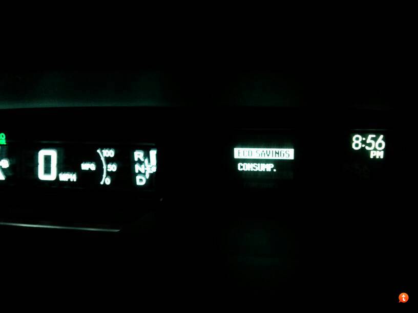

    Just checked and it is set to "Eco Savings". I also checked to make sure the Fuel Cost and Comp. Consumption were correct as well. Here is a picture of the console showing the information. Any other thoughts?

    I think I am confused. The Eco-savings you set in the settings menu only shows when you turn the car off. It shows along with the segment mpg, etc. It does not interface with the screen you are showing. As far as I know, the screen will only show fuel cost, no comparisons. I do not use it, however, and maybe you can configure it differently.

    This is exactly what I see when I turn the car off no matter what setting I have, Eco Savings or Consumption.
    Here is the crux of the problem. What does that setting do if it doesn't change the Eco Savings Record or the Trip Summary at shutdown? I have seen multiple times throughout this forum where people talk about their ESR showing how much they have saved, but based on our findings so much they haven't shown anything real.

    I am not sure where we are in this discussion, but the Eco Savings screen says "fuel cost" where it should say "savings". You need to set the Comparison Consumption screen in the Display Settings screen to "Comp". I think you have it on "Eco Savings".

    Alright, I have finally figured out the mystery. It seems there is an undocumented feature that let's you switch the graph between Savings and Fuel Cost. On the ESR screen, if you tap the Trip button, it switches between the two modes. Also, on the ESR screen, if you hold down the Disp button, you will be taken to a monthly MPG screen as well. Why are neither of these in the User Manual?
