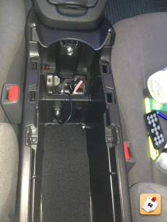

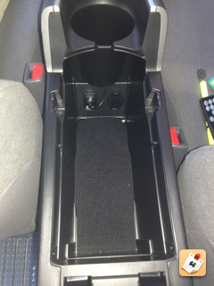

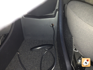

  5. yoyoman
    yoyoman Active Member
    Apr 19, 2005
    342
    117
    San Jose California
    This is what I have done. Refer to my pictures below.
    1. Remove the cup holder in the center console.
    2. Use a dremal tool and cut a small section to allow wire to go thru. Re-install the cup holder.
    3. Drill a small hole just enough to feed my iPhone connector going thru the hole.
    4. My iPhone cable is long enough to reach the dashboard so I put a piece of Velcro to hold my iPhone next to the prius screen.
    Turn off signatures in Tapatalk Tapatalk
