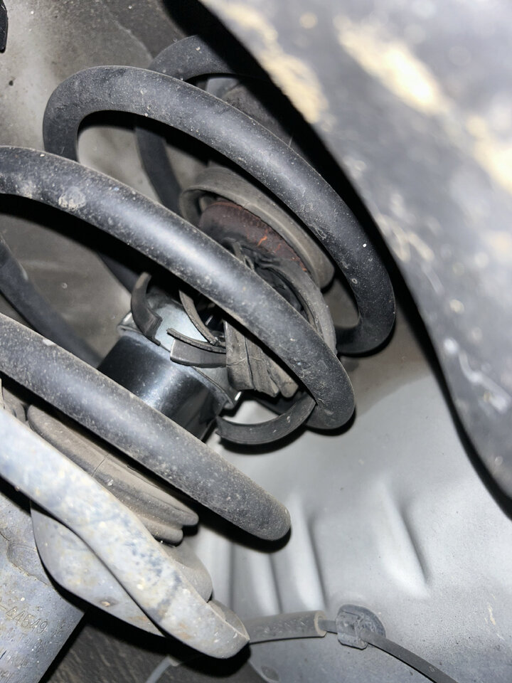

    Once you see the dust boot being compromised, the lifespan of your Front Strut is limited. Now you have small rocks hitting the shock piston making things worse.
    Even to the extent where part of the dust boot is buried into the bump stop making even more noise

    For many many years, the front shocks on cars had no dust boots.
    My 2012 Prius v has only 34k miles on the odometer.
    The thin rubber of the dust boots I often shred with age from ozone exposure.
    While the piston rods may be more subject to damage, I'd only replace the struts, if and when they start leaking.
    RightOnTime likes this.

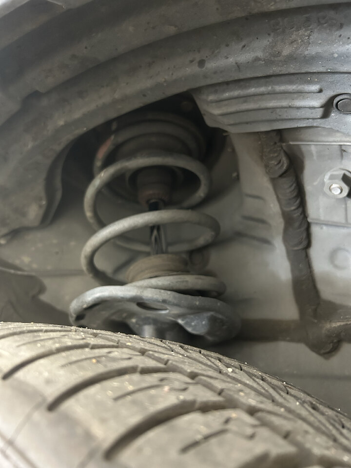

    Got to go old school and remove the springs and compress the shock by hand. If the piston goes up slowly you are good. If the piston stays down then you know the answer.
    From my experience, any Prius with over 150k the front strut is toast. Especially if the car has 300k miles……cough

    To prevent any of the degraded rubber from the bellows from entering the space between the piston rod and the seal, the debris needs to be removed,.
