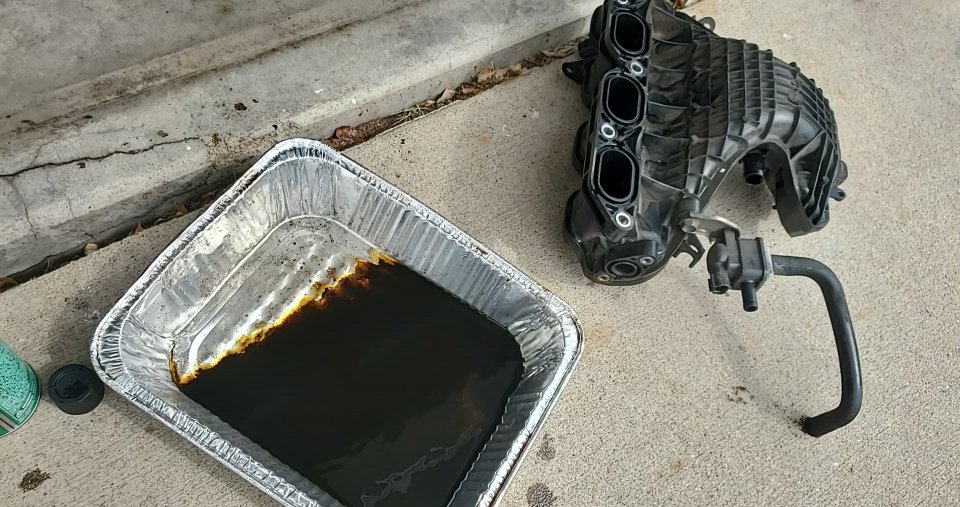

    intake2.jpg i started the process today and heres what the intake looked like, two right i already wiped cleaned the two lefted is what i found them all looking like, i recommand everyone do this to their prius and install a catch can, i can see why its needed now! intake.jpg this is what i got out from the intake maniford useing brake cleaner and scrubing with a brush, when i took off the throttle there was a little puddle of oil in the intake maniford, the thing is my car is running perfectly so this is something that i can totally see killing the ring or head gaskets.
    i wish i could do the EGR but it started snowing agian so itll have to wait as for the catch can, i had to order the hoses from amazon since no auto store near me has them.

    So if I'm reading right, that's a picture of (1) a foil pan, containing (2) a bunch of brake cleaner, mixed with (3) whatever amount of oil was in fact in the manifold?

    i would say about two tea spoons of oil, lots of carbo/dried oil build up and one can of break cleaner, i didnt notice any improvements to the MPG after i did this job, but i did see major improvements to mpg when i install an oil catch can, my guess is the extra oil being sent into the intake from the crankcase made the engine work alot dirtier/harder.
    this isnt an hard job to do, if you worked on your own cars for a while bc screw paying shop prices when i can just buy the replacement part die 1/50th the price they charge for labor. i did over touque a few screws and snap them in half why inside the throttle body, luckly i had an extractor drill bit and ache hardware not to far from where i live, i would recommend only hand tighting most od these bolts.
