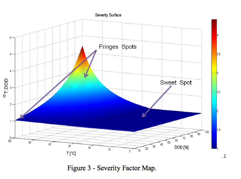

    The following graph from that paper shows the impact severity
    You can see from this why the leaf issues in AZ may be a mixture of high-temps and large DOD (100% charging = 80% DOD) which is much higher impact than normal usage resulting by a factor or 2-3x accelerated aging. (Note the model does not include aging effects from sitting at 100% charge, with as I recall, other studies found accelerate aging at more than 10X "time")

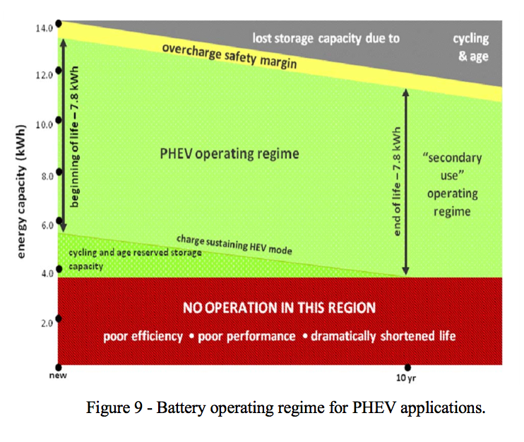

    In that paper they model for 10 years 100,000 miles and produced the following diagram of battery capacity
    Showing a drop over 10 years/150,000 EV miles from 14kw total capacity to 12kw total capacity. In their moded car with about 7.8kw of usable capacity, that would be a EV range of about 25 miles, so 150,000 is about 6,000 cycles.
    If the car is operated within its proper battery support range and has a TMS (which the Telsa does), than an EV with a bigger battery, which means even less DOD on daily usage, so do nearly as well.
