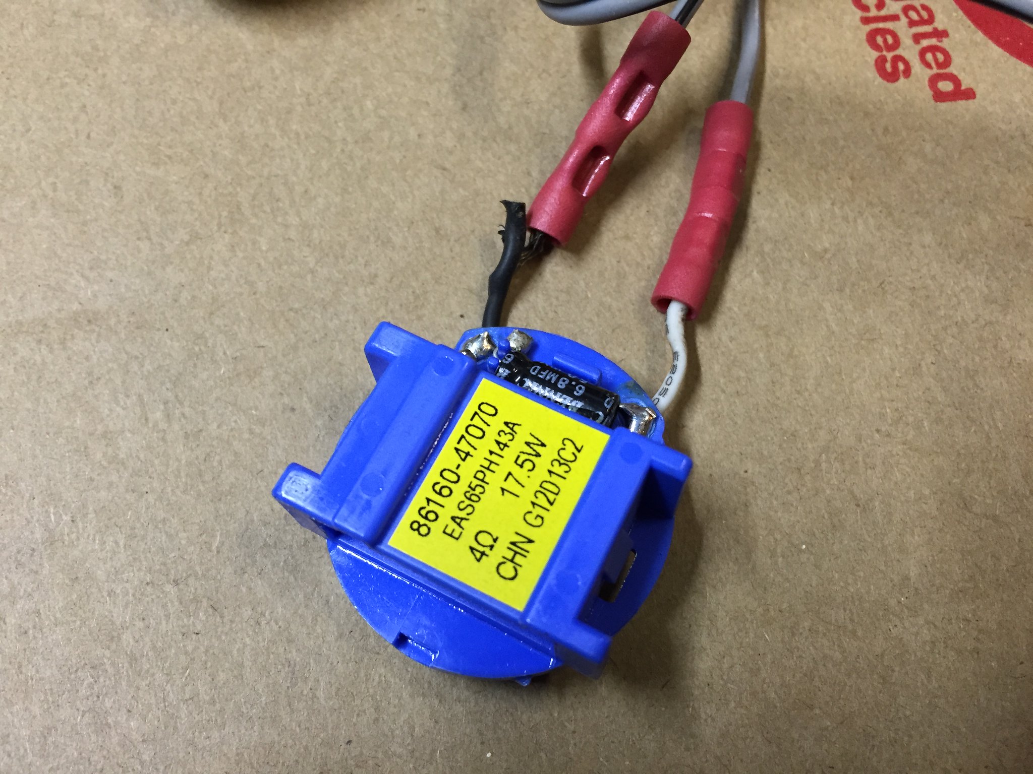

    Agreed that the stock system isn't so great. What makes it really from bad to worse is the terrible reception. I notice a big difference in sound quality between FM, SAT and CD's(worse to best in that order). I just replaced my squawkers in the dash last night and I can see why it's so bad. Paper cone and very low quality. See pics below. I replaced them with speakers from Crutchfield. Kicker 3.5"(Kicker 41DSC354)
    for $29.
    These speakers are wired in parallel with the door speakers so you can either make a jumper or reuse the connector like I did. Just de-solder and pry them off the back(just the blue part).
    The sounds is very different mainly due to a frequency being produced. I actually need to turn the treble to flat or 0 now. Prior to this, it was up at +3-5 depending on music. Even then, there's no comparison as it's just a freq range that the stock speakers can't produce. So for $30 and labor, def. worth it. I will be changing the door speakers front and rear next.
    Use the factory bass blocker and connector as adapter.
    [​IMG]Kicker 3.5" install by sfcyclist2012, on Flickr
    Comparison photo of Kicker 3.5 and stock squawker.
