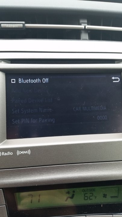

    Just got my new 2015 prius a few days ago. Paired my phone and everything was working fine. Just yesterday bluetooth starting turning off about 30 seconds after I turn on the car. When I got to set up bluetooth the screen says bluetooth off, but can't change it. Is there a way to manually turn it back on? Any body has had the same problem?

    I am having the same problem. Worked fine for a year and then a couple of months ago this same thing started happening. Once it drops and the car shows bluetooth off, I can't reconnect my phone without turning the car off. I have tried to open entune before starting the car to make sure the app is running but it doesn't make a difference. It seems like mine disconnects after I start driving and go above a 25 or 30 mph.

    I stumbled upon this mysterious " Prius bluetooth off" issue today and this solved the problem right away.
    ( 2012. Prius Plug-in
    Samsung Galaxy Note 8 )
    The solution comes from SID000.
    She found it at an android forum.
    Bluetooth
    Paired devices
    Settings
    Disable text
    Thanks for helping each other.

    I have a 2015 Prius also and my bluetooth was shutting off 100% of the time as well. I deleted the pairing and paired it again as a new device. During the process, one of the option was to allow for "Text/Message" access. I made sure this time to select NO. I have to say after 4 months with this bluetooth challenge, this problem has finally solved for me and I have been content for 2 month now. I hope this helps others.
