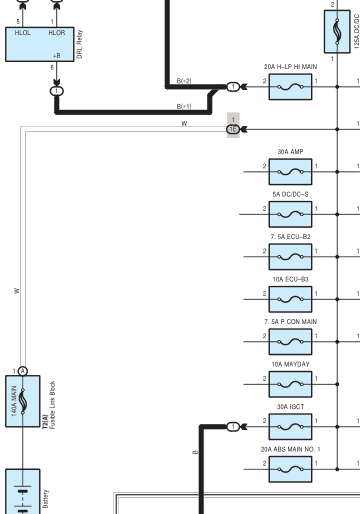

    There is no "charging system" for the 12 volt battery; there is simply the car's 12 volt electrical system, which the battery is directly attached to, as well as the DC/DC converter that supplies that whole system with power when the car is READY.
    The output of the DC/DC converter in Gen 3 is generally between 13.5 and 14.8 volts, and that is the voltage that arrives at the battery. The converter is rated for a maximum output of 120 amps, and there are only two fuses between it and the battery: the 125 amp "DC/DC" fuse in the front fuse box, and the 140 amp "MAIN" fuse at the positive battery clamp.
    There isn't anything in the circuit that specifically limits what current will go into the battery. Nothing there but fat copper wires. Whatever current the battery will accept, in its current state of charge, at the voltage the DC/DC converter is supplying to the car, is the current that flows into the battery.

    What controls the power that goes to the converter in the first place? There has to be something else going on in the background that is complicating things when the 12v battery gets flaky. I keep seeing tons of admonishments to limit charging current to the 12v battery so it doesn't get damaged so something must regulate it. Or are you saying since resistance is fixed and the only other variable is the tight voltage range that keeps current in check automatically?

    Yep, everything in the car except for the hybrid powertrain itself and the compressor for the A/C.
    I think in some trims (the ones where the power steering motor is brushless, which I think are the ones that came with 17" wheels), that motor may be fed a somewhat higher voltage, but just boost-converted from the 12 volt system still.
