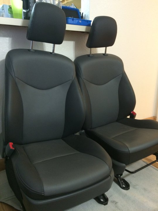

    these are the seats i found thru eBay, from a salvage dealer somewhere in the MidWest. Shipping was lightning fast to CA in 3 days. Not bad. No scuffs to any foam imprinting from wear - I was pleased. However - the fed ex guy mentioned a seat fell off the truck so I may want to start the claim process to Fedex asap if there were any issues. Turns out, my driver side rail is twisted, so the power forward and up and down doesn't work well when the seat is bolted down. unbolted its fine -

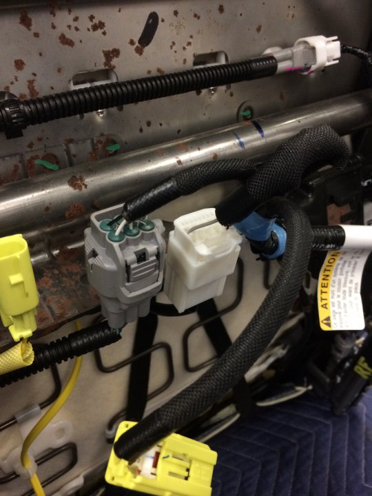

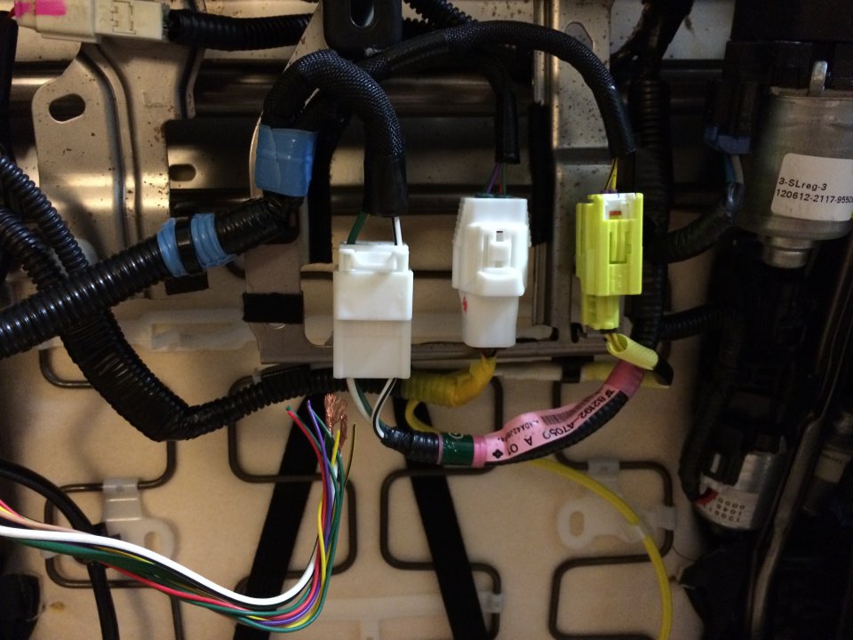

    (picture 2) So these are the connectors on the bottom of the donor prius power seat. Left clip is power, middle clip is sensors for weight/seatbelt and yellow is airbag. We will be reusing the factory clip and tapping power and ground into these locations to keep things tidy. At this time you should check your seatbelt clip to see if it is compatible with the donor clip. I found out the hard way after we had bolted everything in and assembled everything back. My buddy and I were all like high fiving and saying how easy this was and then...realized we couldn't put our seatbelt on to go on a test drive...fail...

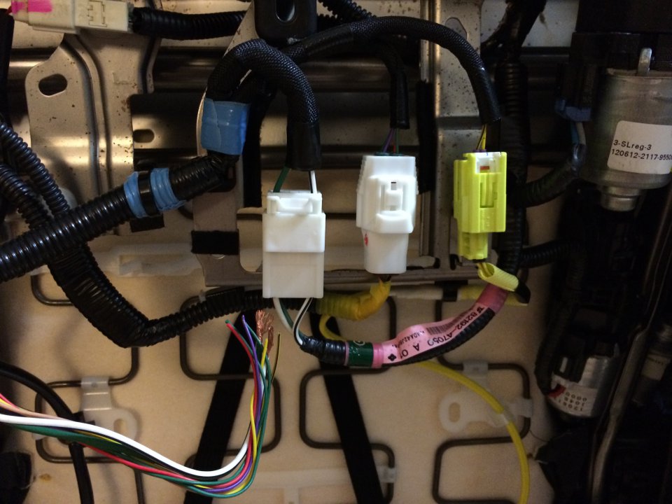

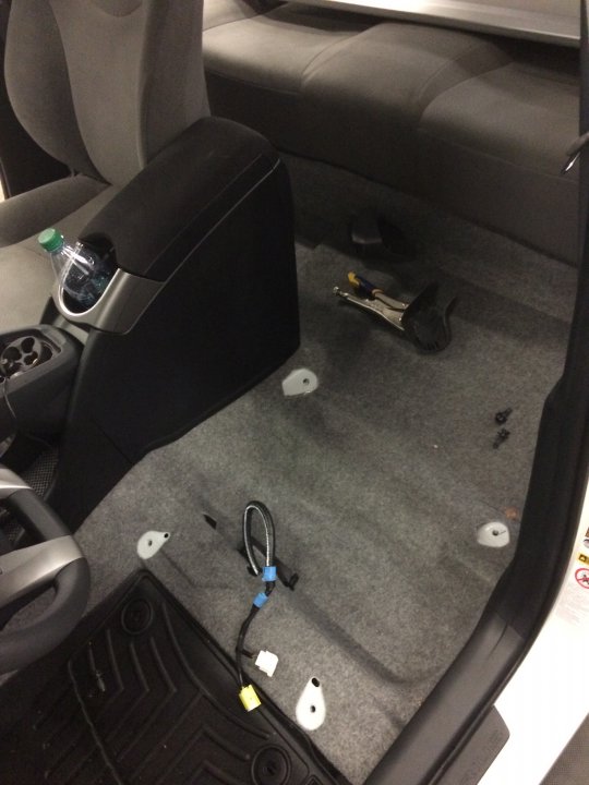

    Ripped out the stock seat. As you can tell in the above photo - the yellow clip is the current recipient airbag sensor and weight/seatbelt sensor clip. You will need to run a power from the fusebox in my case, under the carpet where the factory wiring loom sits. If you do need to run a different seatbelt clip from the recipient car, thats the clip it'll be popping into, later when you are assembling everything together.
    Seatbelt clip removal - If your seatbelt does not clip into the new seat, simply remove your seatbelt clip from the stock seat, remove the wires that follow down to the frame of the car. It is held on by a t30hex and 10mm socket on the opposing side. Remove this whole harness, cut the factory electric tape and it'll end up as the middle clip as shown in picture two of this writeup. Then swap seat belt clickers out and problem solved.

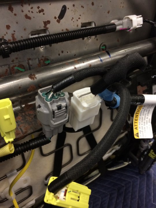

    In my case, in the donor seat, we had 3 wires coming from the white clip shown above. In the recipient car, I had only 2 wires, what seemed to be a power and ground. We tinkered around a bit and figured out that the smallest gray wire was a dud and green was ground/striped power. Power now worked fine - but the seat does not move up and down when bolted down, which suggests the track is messed up - as mentioned by the Fedex guy. If i pull myself towards the direction I want to go towards using the steering wheel while using the power (certain situations slow down. I'm certain the screw servos are binding somewhere... oh well) But with the seat rail unbolted everything works (oh and the seat brackets dont sit flush with the OEM points so its 100% sure a track thing), so now I have to deal with fedex claims...what a PITA...oh well took one for the team. GO LOCAL AND PICK IT UP!!!

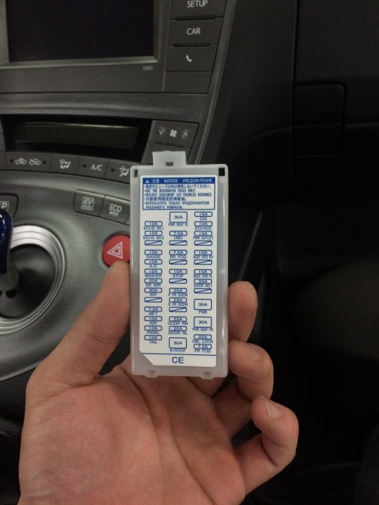

    this it the factory fusebox under left foot parking brake. We tapped the 25A DBL lock for power, since we didn't have any self tapping microbuses that would fit the funny 30A PWR SEAT fuse. If there is something I dont know about here regarding the DBL LOCK fuse plz lmk.

    I'll post another photo of the seats tomorrow once its bright outside. The dark black and white stiched leather seats look amazing with the factory gray/sleet color scheme thing. I also got the black weather tech digiliners and together look really upscale.

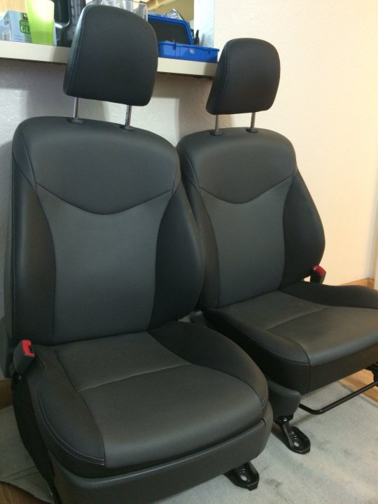

    Figured I would post on this thread. I’ve had my 2015 Prius II for about a month now. I originally test drove one with leather seats but it was pretty worn out (both front and back bumpers were horribly re-painted, 85K miles and few other things. Ended up getting a used 2015 with 43K miles and had been looking to install leather seats.
    Luckily I found some at a junk yard from a 2012 that had front end damage. Picked them up this past Tuesday and install them today. Photos attached.
    The guy who runs the junk yard also gave me the arm rest/center console for free

    Looks nice. How much did that set you back?

    Thank you! Paid $400 for both front seats and back seats and like I said the junk yard owner gave me the arm rest for free

    1. In the beginning, you said there are these 3 connectors on your new "donor" power seat in the pic below:
    But your car's chassis only has the following 2 connectors:
    So you plug in your 2 chassis connectors to the new power seat (yellow to yellow, white to white) as in the following pic? Where did the grey connector come from?
    Do the 2 connectors (yellow and white) from your car's chassis fit directly onto 2 of the 3 plugin ports on the power seat?
    What about the third connector? What do you do with that other white connector port in the new power seat earlier and why is there a grey connector shown in this pic?
