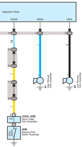

    Shouldn't be too hard to troubleshoot. I'd start by taking off the steering-column shroud and poking a wire between L52 pin 8 (yellow wire) and body ground, and seeing if the horns honk. If not, I'd do the same at the connections progressively closer to the integration relay. And so on.
