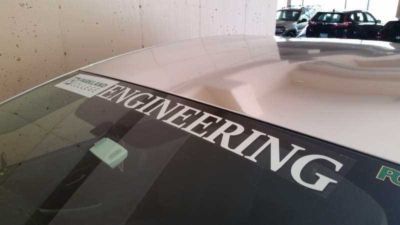

    I'd be interested in a photo of the roof wrap... was that 3M vinyl chrome? did you do that yourself? and yes, I do miss the handbrake. Did a few turns as navigator running an original Mini on some rallies with the U of Buffalo club, the radiator leaked so had to stuff snow in it a couple of times. Nothing like hanging on while careening down dirt logging roads in the snow at night... or skipping a stage check-in because there's a local getting out of his pickup with a shotgun... :eek:

    You can see some of it here:
    It's just cheap wrap from Amazon. I bought a small piece of white and a piece of chrome and stuck them to cardboard boxes, then stuck thermometers inside and left them both out in the sun. Chrome stayed cooler, so I got a bigger roll and did the roof. We'll see how it holds up; it's fine so far after more than a year parking outside.
