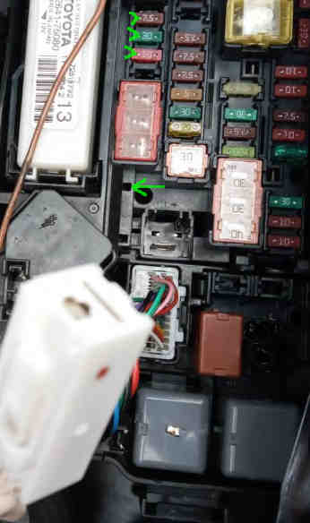

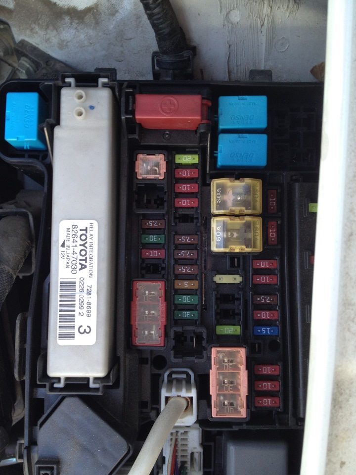

    Does reading at the charge port mean the 125a fuse is good? I can't find it (see photo). What do I try next? A tow will be about 50 miles to the Dealer, only option I have. BTW it has been outside in - temps, was working fine, sat for the night, and would not start.
    Can someone point me to 125a Fuse, Could it be one of the fuses under the dash or someplae else.
    Under the black square area at the lower left is a major electrical connection but does not look like a fuse.. does have a bsr that goes across the front of the connector.. which is intact.

    Use a good flashlight, unless its changed on a 2015. There is an opening that from an angle with a light you can see the copper link of the fuse. You can also check for 12v downstream of the fuse when off.
    With flashlight inside of fuse box at an angle
    Straight on it looks like a triangular hole into the box

    Mod note: Corrected in later post: voltage at the jump point does NOT confirm the 125 amp fuse is good. See later post for how to check
    Yes.
    Should you ever need to find it in the future, it's as shown in the photo rjparker posted. Look closely at the photo so you recognize the angle it had to be taken from. But right now, you don't need to find it, because the reading you got means it's ok.

    Actually voltage at the red jump point does not guarantee the 125a fuse is good. It does say the 140a at the battery is ok. Check power on the 30a engine w/p fuse with the system off.

    Sorry for my brain fart. Yes, rj's right. I even posted a photo back in April showing several easy places to test for the condition of the 125 amp fuse, and then forgot all about it when I posted above.
    If you put one meter probe on a good ground and touch poke the other down the square hole with the lower green arrow, or touch it to any of those green-indicated test points on the fuses above it, a reading of battery voltage will tell you that fuse is good.
