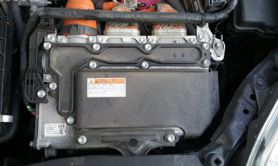

    Is there a big steel "skid plate" over the top of that inverter? When did that start? My 2010 doesn't have one.

  12. ChapmanF
    28,743
    19,042
    Is that a big steel skid-plate-like-thing over the top of that inverter? When did that start? There isn't one on my 2010.
  13. Mendel Leisk
    61,575
    42,364
    There is a plastic cover available, but it covers the whole thing. Yeah, picture of our 2010:
