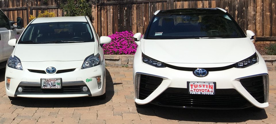

    The cold does take a significant toll. I loved my 2006 - but the 2012 PIP I now have does give me better mileage and range even without plugging in (bigger battery). The worst mileage of the Mirai though now matches the best I could do with the 2006 Prius. Progress at any cost ! :-P
    I just posted a couple more pics showing the 2012 Prius next to the Mirai in OldNSlow pics.

    Nice pics!
    I like this one
    The MIRAI looks angry and the Prius looks surprised and happy :D

    I'm not a fan of that front grill although I wasn't a huge fan of the front grill of my last car either.
    Is it not a hatchback? It is hard to tell from your pic and the pic on the website doesn't show it.

    It's a sedan.
    The difference is that the large grille is functional and needed to cool the FC bits under the hood. If you zoom in, you can see that it's hollow and air actually flows through most of the area. Only a relatively small bit is solid.

    do not know if it's the angle or what, but that car looks enormous next to the prius

    It's a sedan with a trunk, not a hatchback. I am standing closer to the Mirai in the above photo and it is slightly more forward than the Prius, but it is bigger. Will post another photo below. Also posting a photo of the grill area - the top three slat areas direct air to the side openings. The bottom two are completely open - you can see the radiator behind it.

    I was told it was for cooling. You can see a better pic above this post.
