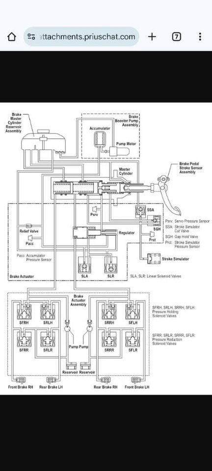

    Here's a basic system diagram (from elsewhere in the forums). The booster pump assembly and the (upper?) brake actuator are the only parts that contain high pressure fluid while the brakes are not in use.
    Deleted member 219929 likes this.
