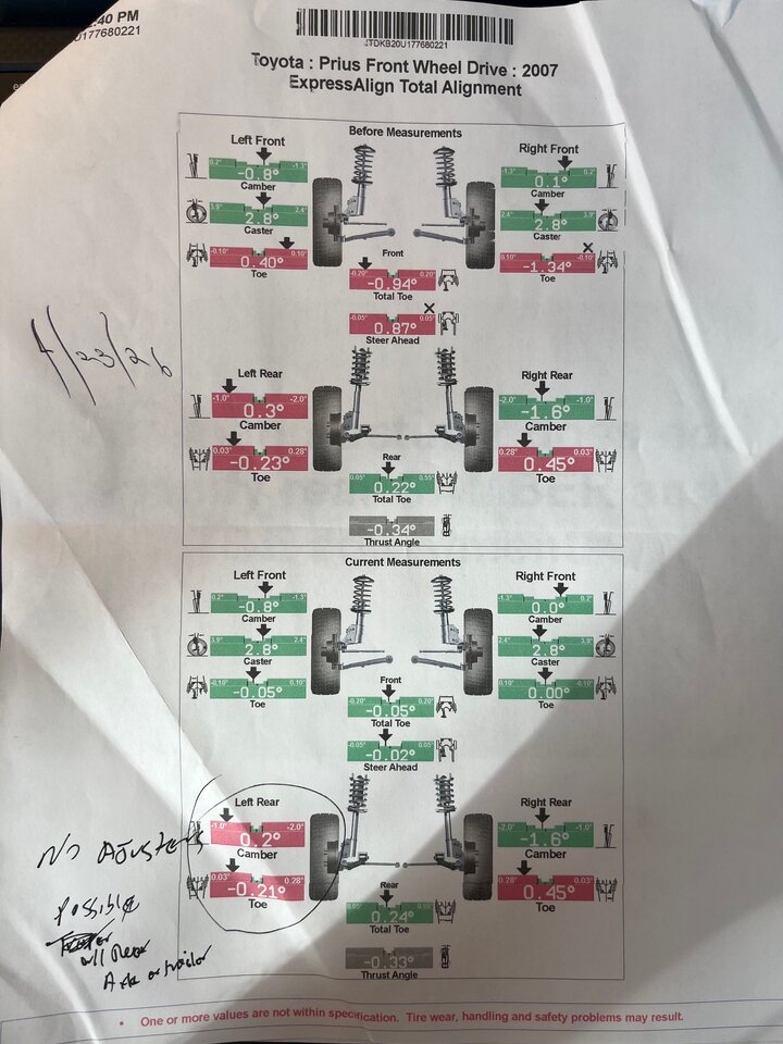

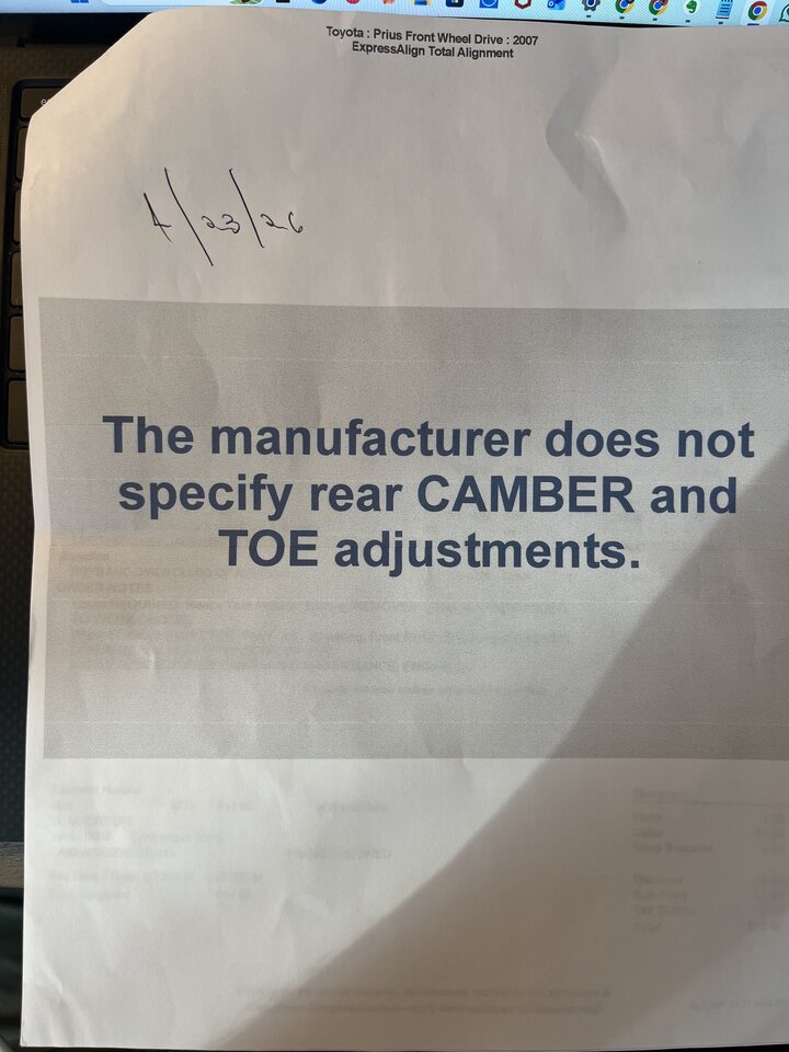

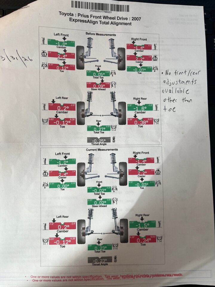

  4. Stuart M Whitaker
    Stuart M Whitaker Junior Member
    Dec 20, 2019
    Virginia
    Alignment and tire wear: I'm pretty religious about alignments but Bridgestone Turanzas warranteed for 80000 miles wore out after 32000 and tire vendor blamed bad alignment. Firestone "aligned" my 2007 2nd gen last month. Their report indicated 7 of 10 measurements out of spec when I brought it in and still 6 of 10 measurements out of spec when they were finished--the technician wrote that there are no adjustments front or rear other than for toe. Tires Plus (same parent as Firestone) aligned same vehicle this month. Their report indicated 5 of 10 measurements out of spec when I brought it in and only 3 of 10 measurements out of spec when they finished--their tech attached a sheet saying manufacturer does not specify rear camber and toe adjustments. I have similar experience with my 3rd gen Prii as well. Can anyone explain what's going on?
