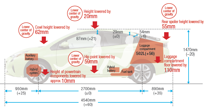

    As far as Gen4 being +56-liter (2-ft3) over Gen3, see further above Tideland posted the following graphic excerpted from the Toyota-Japan engineer's presentation thread:

    Here's the specification for the E-Four model (same as 2WD WITH spare tire). So we can use the relative difference too.
    The difference is 45 litres or 1.589 ft³. This is closer to your 1.4 ft³ listed in your "true" luggage volume. This compares to 2.4 cu. ft. for the Toyota difference. If the measuring method is the same, how can Toyota claim a larger difference?

    Yes I tried to use the 457 number from your orig post, I may have introduced a little slop I will tighten up the numbers in the next iteration. Implication either something wrong with the 457/502 delta, or if that delta is correct, something could be different in the rear seat placement or height to make floor level, which in turn impacts a technical measurement in the EPA Cargo Capacity calc.
