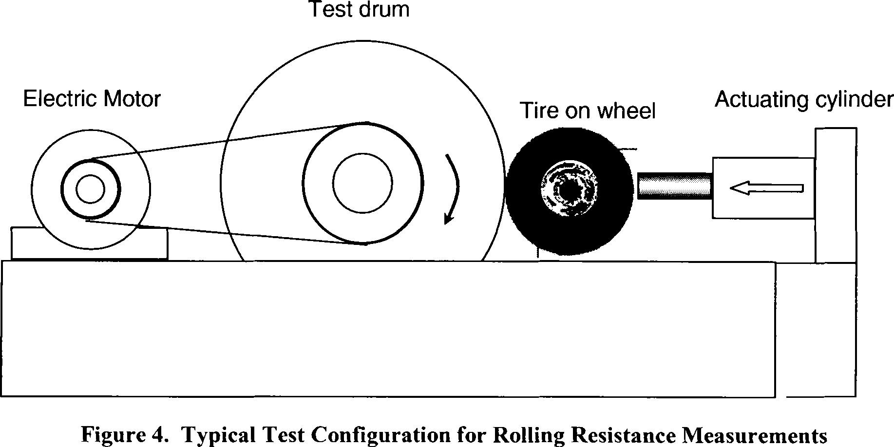

    In actual fact is difficult to understand how industry in NA is lobbying to avoid customer could properly compare tires.... most of the world uses already some classification method (that you can correlate btw different systems)...
    Federal Register | Tire Fuel Efficiency Consumer Information Program
    This is the approach:
    Each RR class corresponds to a range of Rolling Resistance coefficient, taken from test on a rotating bench:
