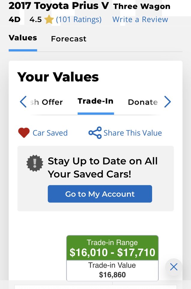

    I tried to get him down to 15k, but he told me his dealer will give him 15k for it.

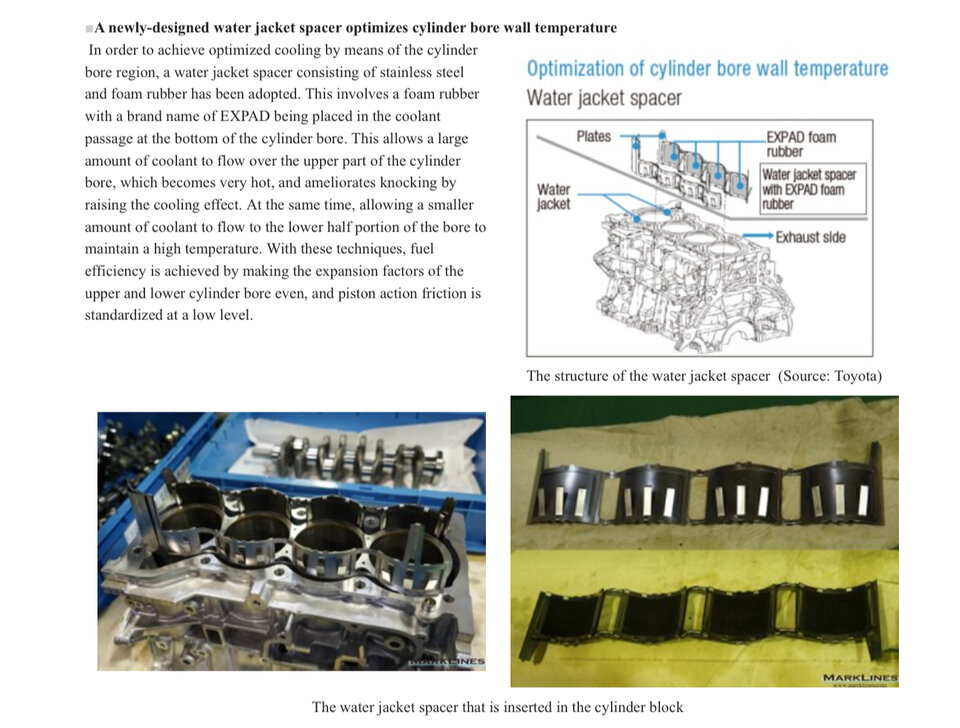

    A lot of gen3 issues are better understood by reviewing the engineering changes to a gen4. There are posts on the forum but highlights include better cylinder cooling channels in the block and head, improved geometry of those mating parts, redesigned pistons (again), revised cooling system routing and water pump, a coolant flow selector valve and a large volume egr cooler taking exhaust gasses after the catalytic converter instead of before.
    Plus gen4 has a cool cylinder insulator (water jacket spacer):

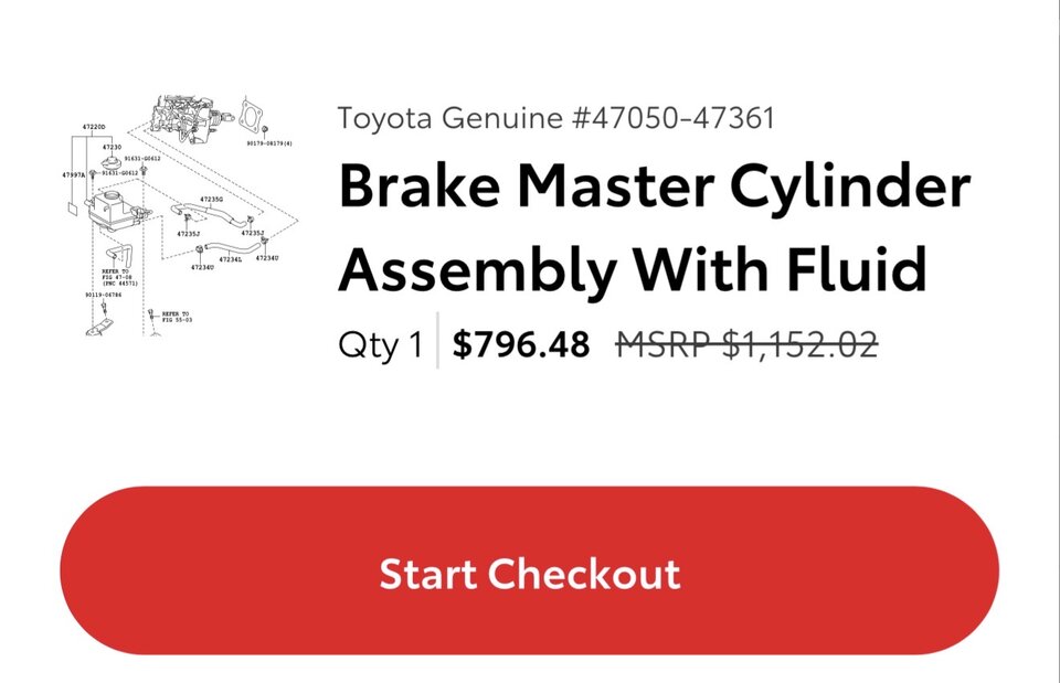

    Brake booster?
    Change the brake fluid every now and then and the booster might last a bit longer.... ;)
